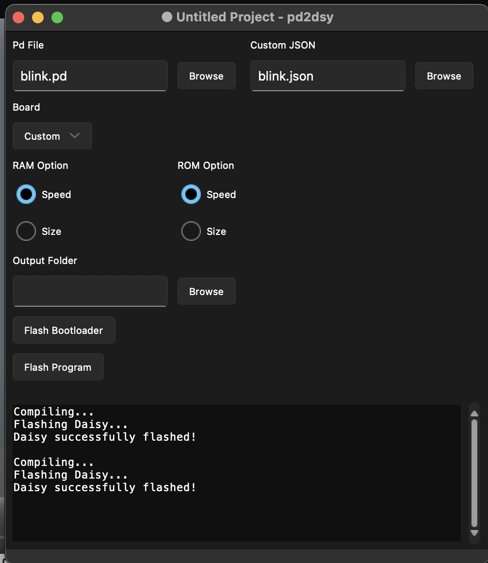

I have successfully (i think) installed puredata, pd2dsy gui software, and the daisy toolchain by carefully following the videos and wikis.

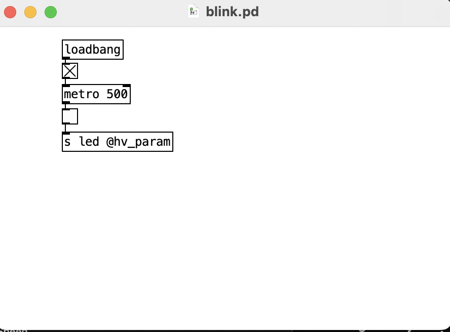

I am able to flash the blink.pd example to my daisy seed, but the LED does not actually blink. It does blink if I use C++ from VSCode.
My log file at pd2dsy_build.txt has this error, but I think that might not be an issue based on other posts I’ve seen relating to Error 74.
Download	[=========================] 100%        82288 bytes
Download done.
File downloaded successfully
Submitting leave request...
dfu-util: Error during download get_status
make: *** [program-dfu] Error 74
I looked at the discussion under with a similar title here, but I didn’t see anything relevant resolving my issue.
Has anyone else seen this kind of behavior before?
