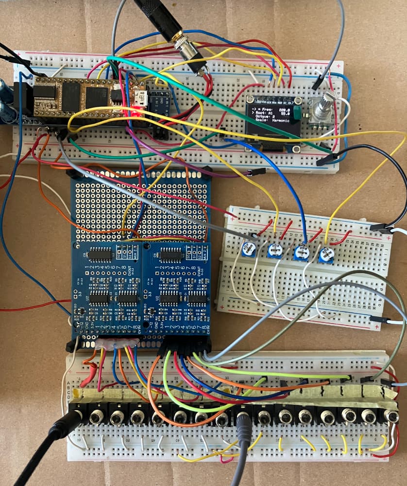

Hi everyone,

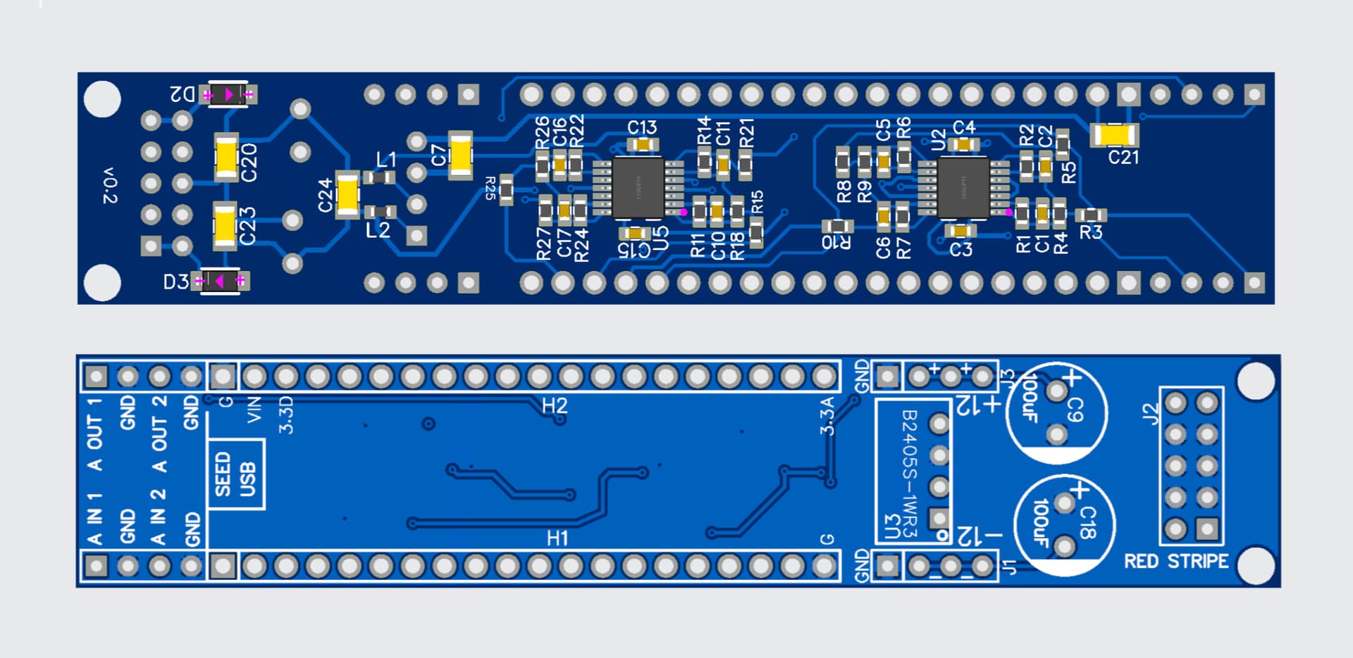

i designed two breakout PCBs for the Daisy Seed // after frying a seed :slight_smile: //
they can be helpful for prototyping, especially when working with eurorack signals.
– DC DC converter and input / output opamps board - Seed breakout Easy EDA project

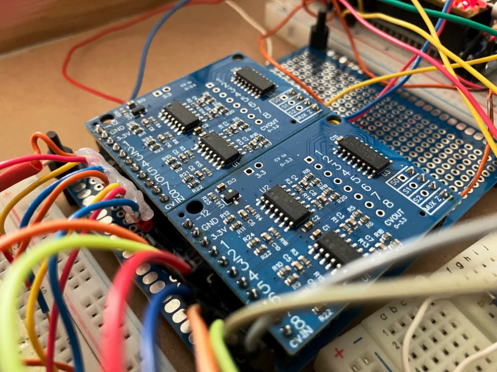

– Eight channel input protection and multiplexer board - protection and mux Easy EDA project

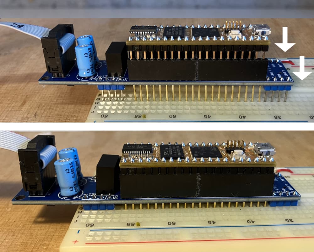

When using long headers it can be plugged into a breadboard for fast prototyping while using the clean power and the op amps. Bit fiddly to install on breadboard, but once in place worth the hassle.
To install on breadboard i use long female headers.
→ Daisy seed with normal male headers plugs in the female headers
→ female headers through PCB plug into breadboard.
All daisy pins are then available on the breadboard, audio in and out through opamps are available, as well as +/- 12 Volts.

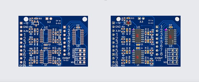

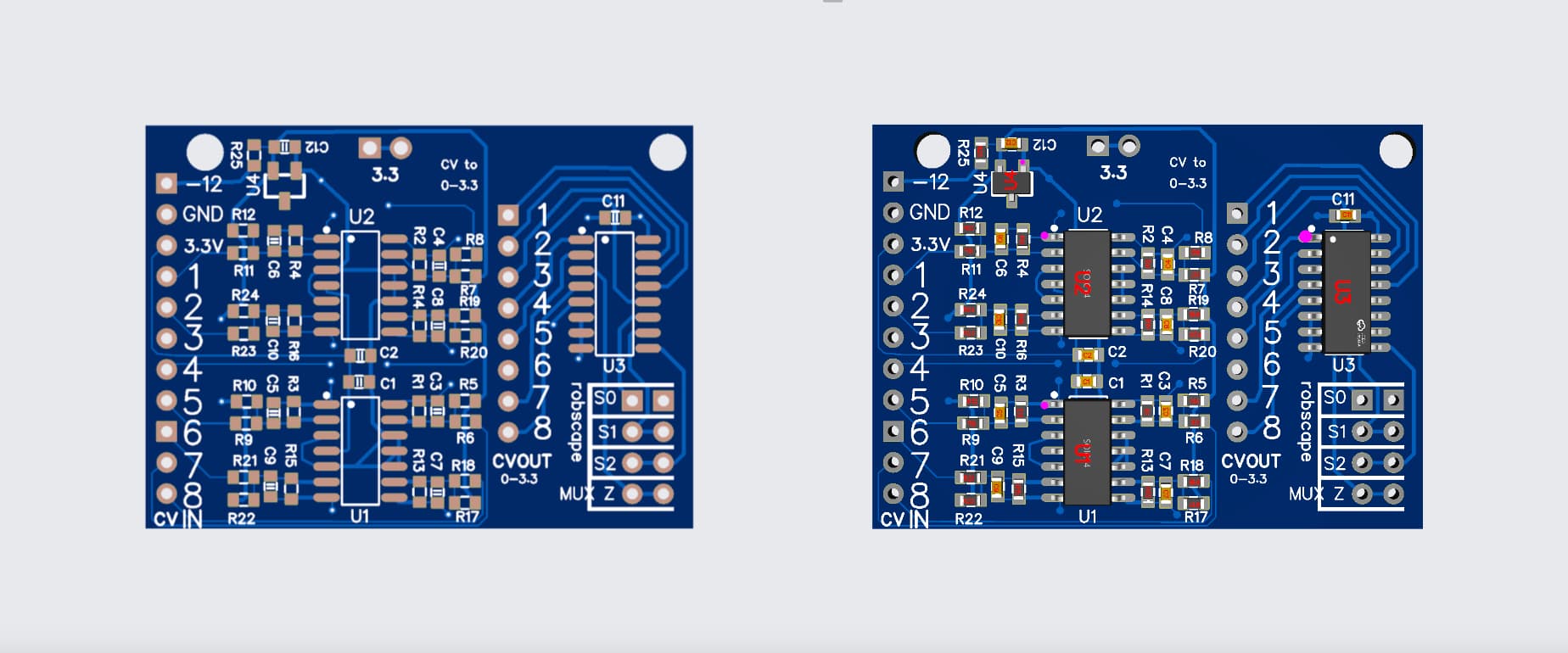

Scales Eurorack level -/+ 5 Volts to safe 0 – 3.3 Volts, these scaled signals can be used directly or via the multiplexer thats on board.
