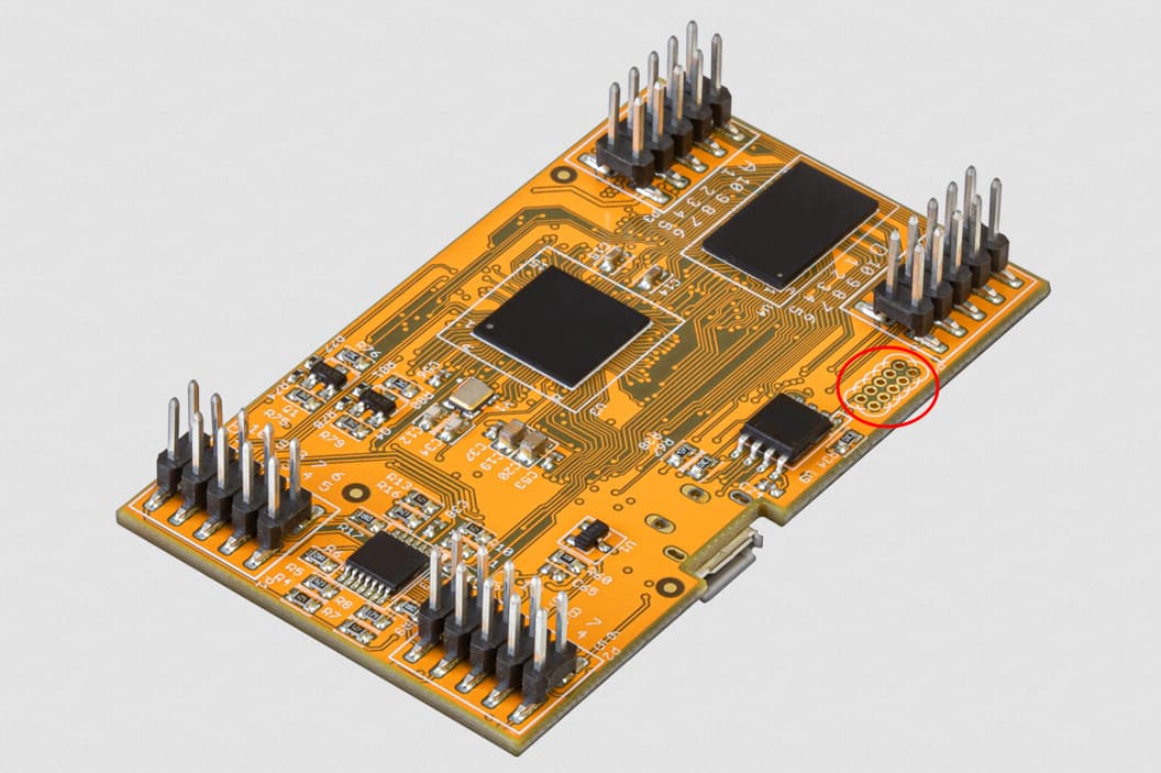

You can see the empty st-link socket on the photo here: https://daisy.audio/img/product_photos/patch_sm/ES_Daisy_Patch_SM_dark.png#only-dark
You have to solder these headers yourself. (note that they are smaller than regular through-hole headers)

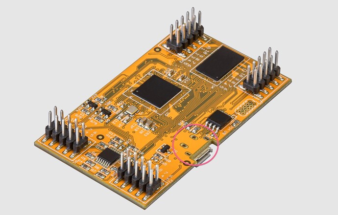

great, thanks. I can’t find any documentation on this, do you mean these 4 holes next to the USB port? Hans.
It’s the 10 little holes.
oyoyoy, I’m blind!!!
