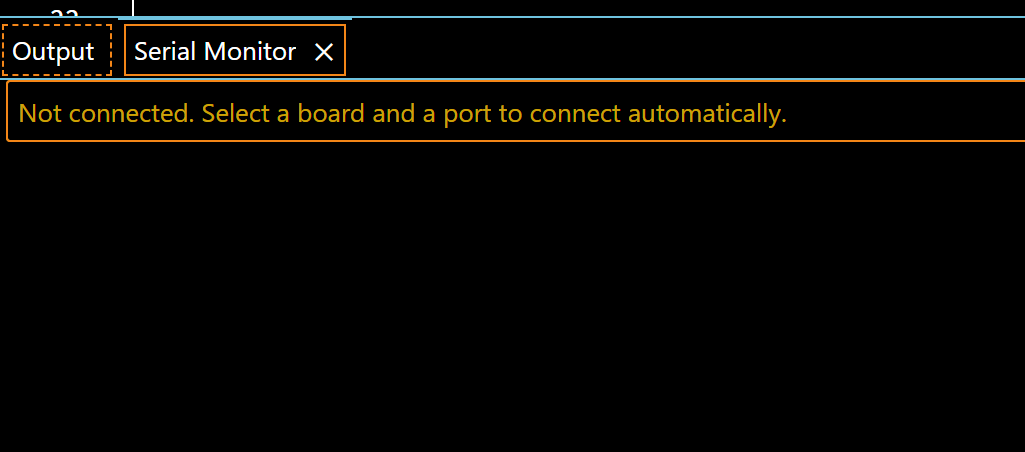

  • I have installed the board definitions and DaisyDuino library, configured based on the instructions on the DaisySeed installation page. See the config image for the settings of the board (image 1)

Thanks @tele_player . Based on you advice, I began a step by step investigation of the USB settings. The settings were correct, but the tests did reveal some more details… Process for tests:
  1. Check all Ardunio settings. Appear as correct, with USB support set. See image 1.

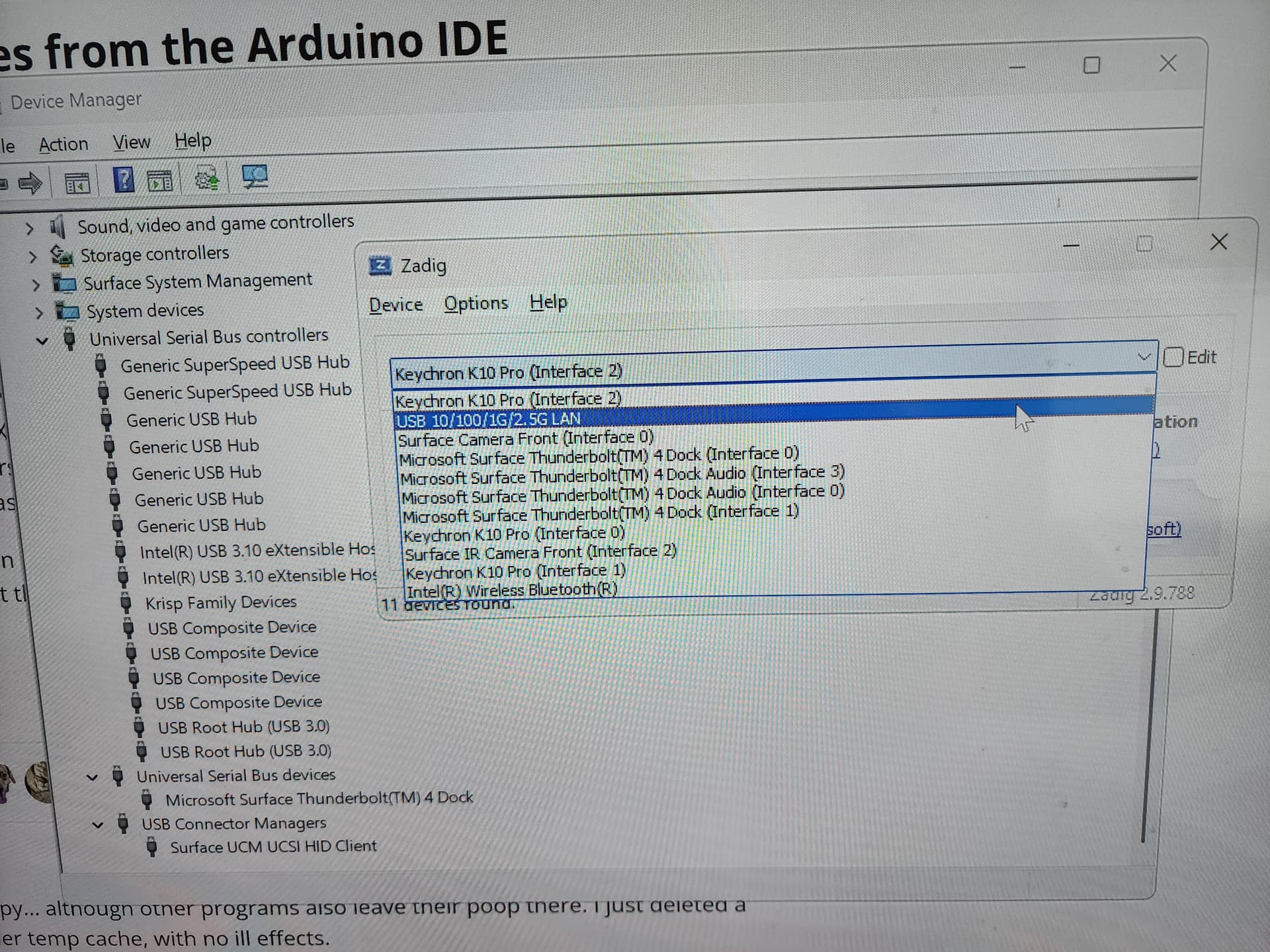

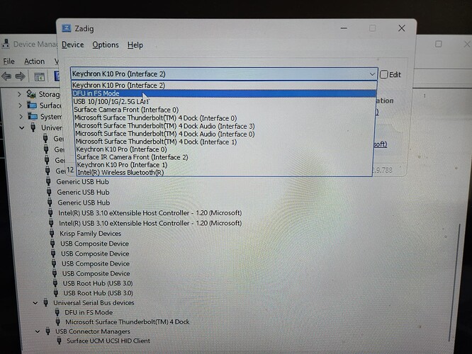

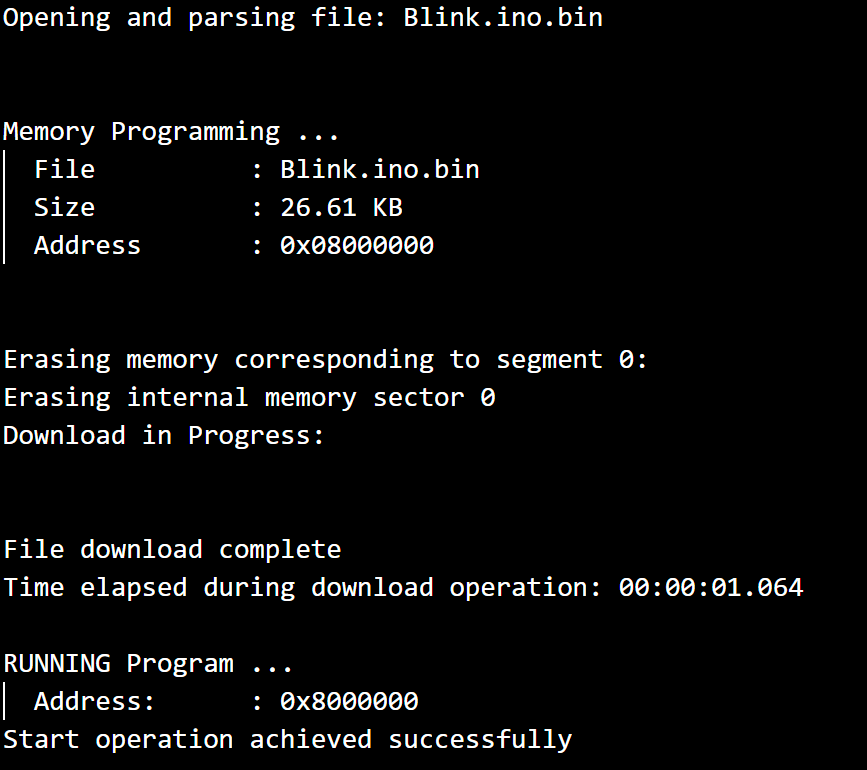

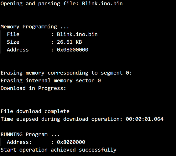

  2. Put DS into boot mode. Hear the ‘USB connect chime’ and application uploads correctly. See image 2,3,4,5.
  3. USB chime once application has completed uploading. DS is not showing a blinking LED. No com port available.

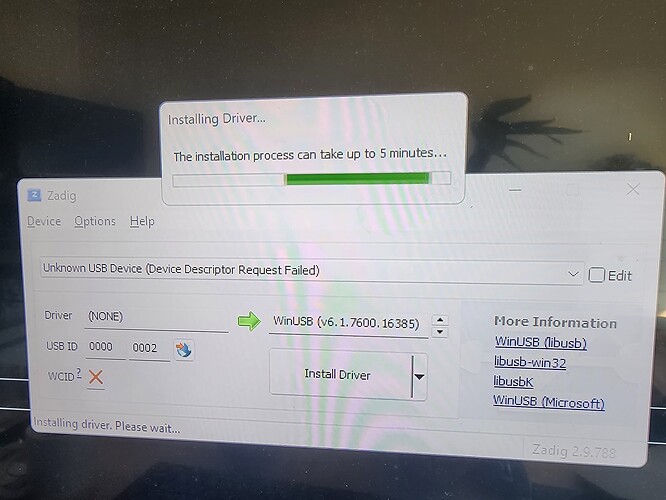

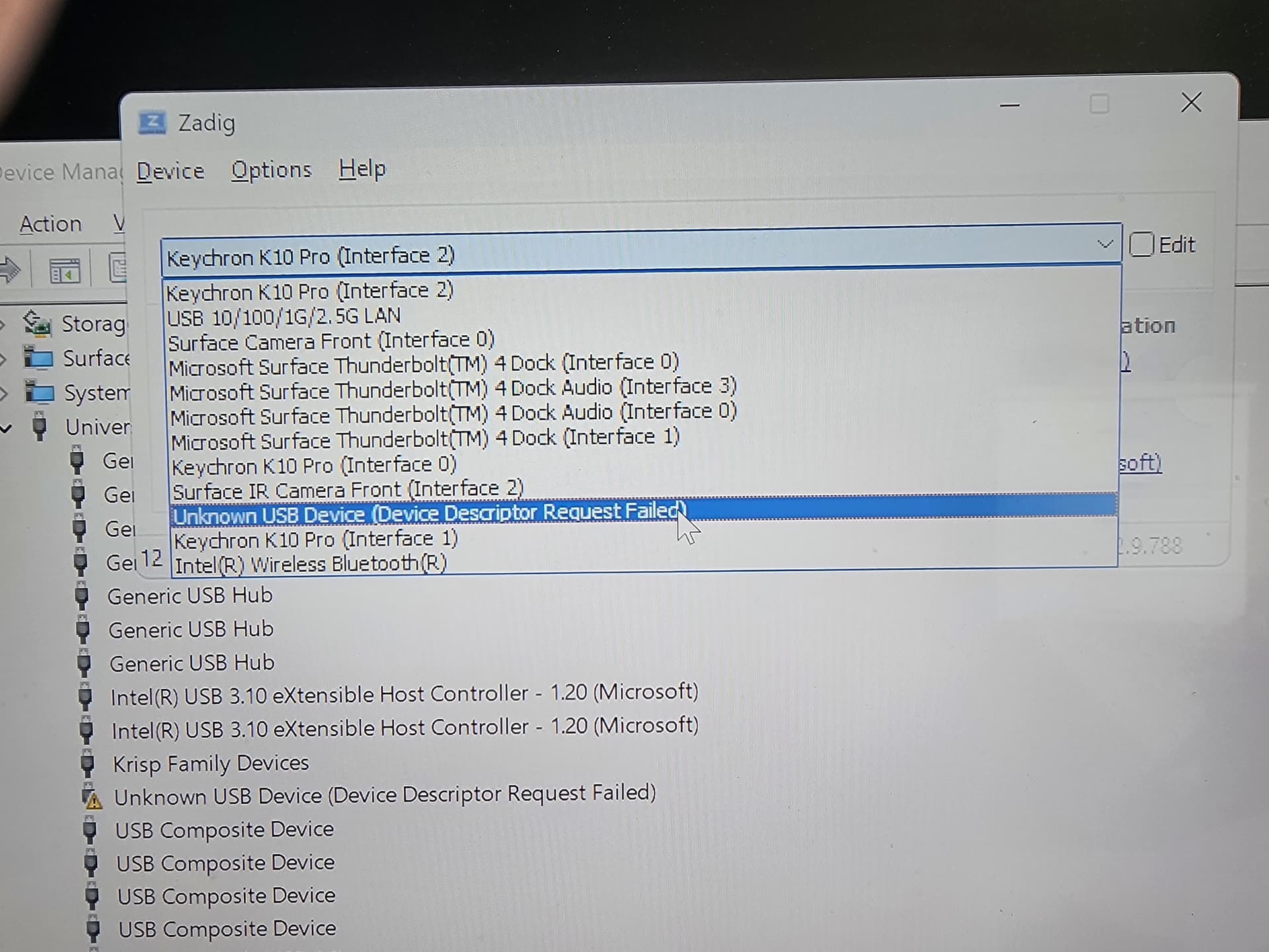

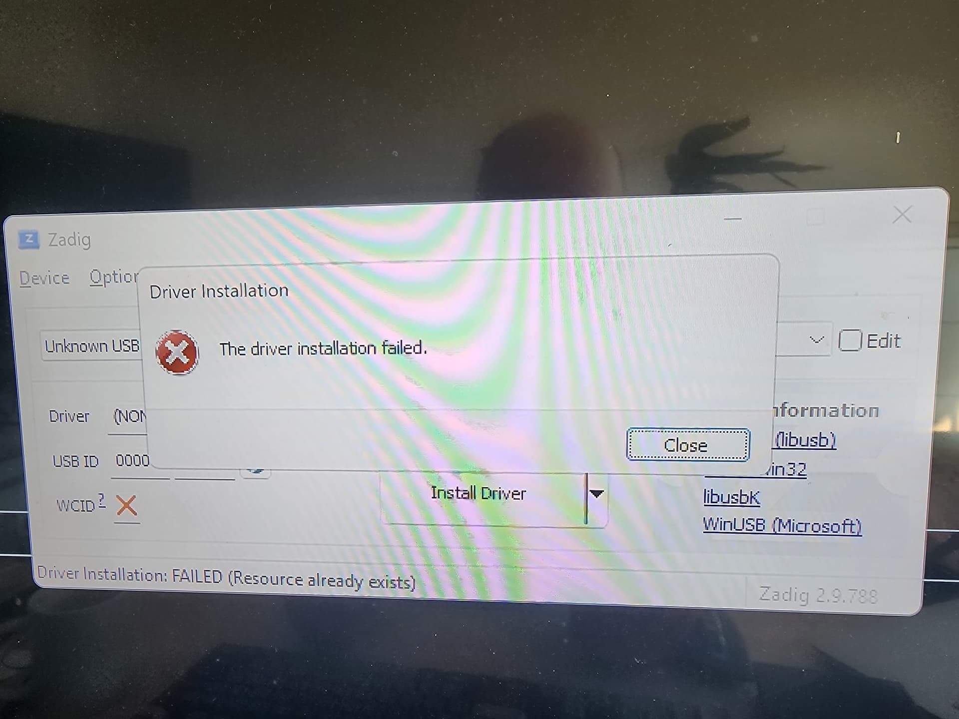

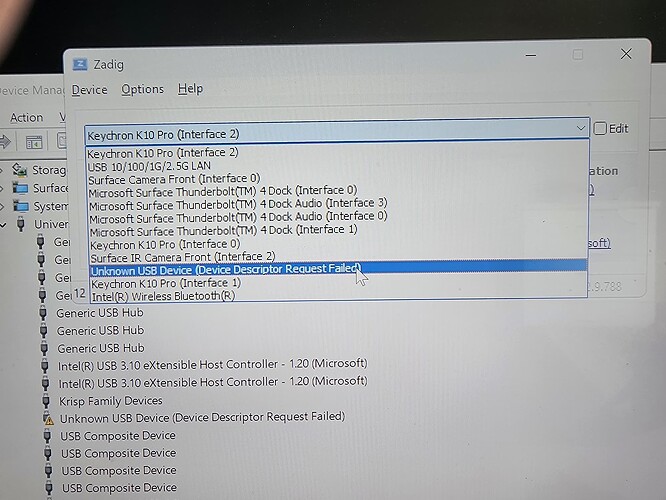

  4. Used Zadig to check USB ports. Unknown USB Device (Device Description Request Failed) found. Attempted to set this to WinUSB(v 6.1…) with Zadig. See image 6.
  5. Setting of Unknown USB Device with Zadig fails. See image 7.
  6. Attempted setting of Unknown USB Device a second time, with same result.
  7. Note that the DS is still not showing a Blinking LED, suggesting the application is not running.
  8. As hail mary, attempted to use Zadig to set Unknown USB Device to libusb-win32, and CDC Usb settings… both failed.

  15. Reconnected DS, and opened IDE. Put DS into book mode and DFU FS Mode shows in Device Manager. See image 9.

  17. Rescanned for devices in Device Manager and with Zadig and the Unknown USB Device is back. See image 10.
So… I now know that Unknown USB Device (Device descriptor request failed) is the DS USB, but it is not able to be configured with Zadig.

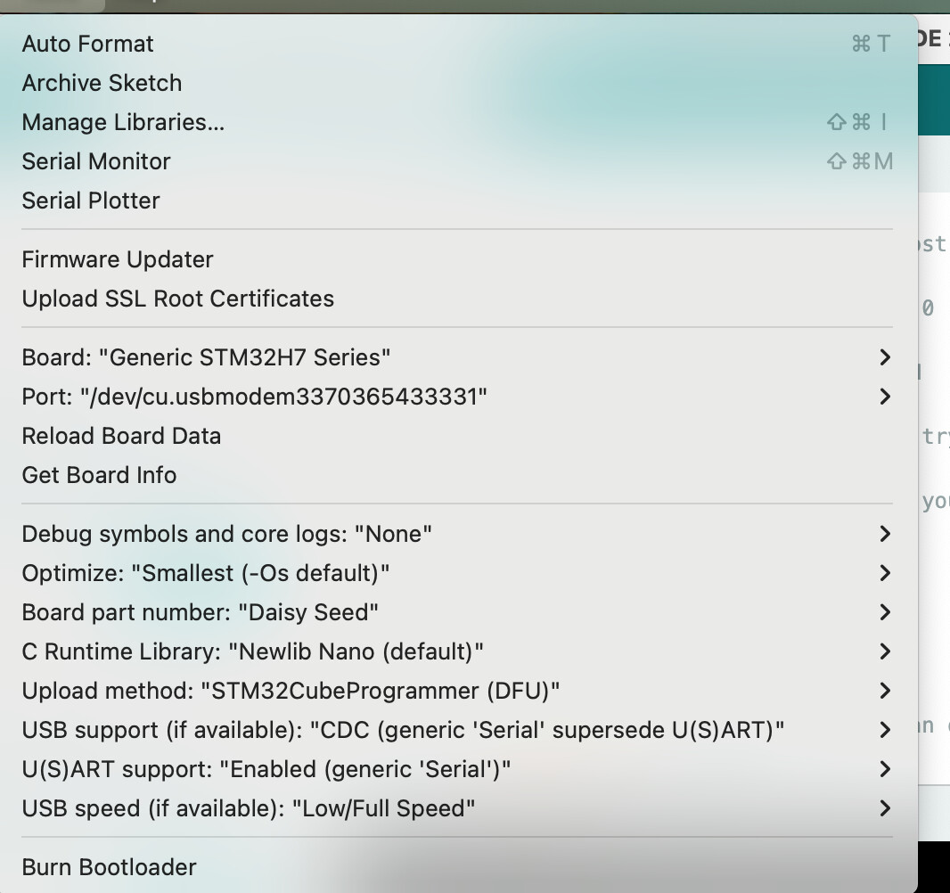

Board: Nucleo-65
C Runtime: Newlib Nano (default)
Part No: Nucleo L476RG
USB SUpport: CDC (generic ‘Serial’ supercede U(S)ART)
Upload method: STM32CubeProgrammer (DFU)
U(S)ART support: Enabled (generic Serial)
USB Speed: Low/Full Speed

Solved -
See Board: and Board part number: below.
Hoooooray. I knew it woukd be something obvious. Thank you so much. The previous settings came from thea daisy seed installation page link to github.com/stm32dunino/Arduino_Core_STM32/wiki/Gettin-Started
Im including that link so other folks on this journwy dont mak we the same mistake as me.
