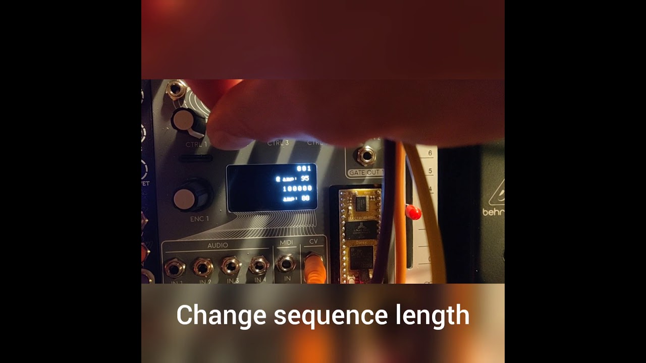

To get acquainted with the framework, I made a Turing Machine implementation for Daisy Patch.
Description
2 channel Turing Machine. Similar to the Music Thing one.
Controls
| Control | Description | Comment |
| CTRL in 1 - 3 | Turing Machine Knob | Noon: produce random cv, 5 o’clock: cv values lock into repeating sequence, 7 o’clock: cv values lock into inverting repeating sequence twice as long |
| CTRL in 2 - 4 | Length | set sequence length |
| Gate Ins | Advance Sequence | |
| CV Outs | CV out | Either random or looping CV, depending on CTRL 1 and 3 |
| Encoder | Navigate Menu | Turn to move through steps. Press to enter/leave submenu (values), can be used to adjust amp value to attenuate outgoing cv |
