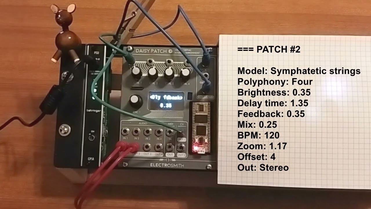

While learning to program the Daisy Patch, I experimented a few days with Torus (by Ben Sergentanis (Daisy porting) / Émilie Gillet (original Rings)) , and decided to make a “Plus” version adding a delay and a rythm/note generator in order to allow self-patching.
I’m not too thrilled with the result, but I decided to publish it.
Source code/firmware downloadable here: https://github.com/algoritmarte/algodaisy/tree/main/patch_algodaisy/TorusPlus
Still working on it, but let me know if you have some suggestions to improve it.

Thank you for the suggestions! (yesterday I made a small correction to the 1v/oct IN handling if you want).
  • adding scale mode selector → yes this is definitely one of the things to add (though the base offset is already a way to switch to another (diatonic) mode; but other non diatonic scales could be interesting
  • adding euclidean mode pattern generator a kind of turing machine → the rythm generator is already a 4 tracks euclidian sequencer (aggregated in pairs), but it is not “editable” and probably there’is not enough space for the editor → I’m working on a separate module “Nautilus” which is focused more on editing/controlling what is generated by the Diasy and has a SD-card sample player, but if there is enough spce I’ll integrate it into TorusPlus
  • delay on/off → actually you can set the mix level to 0 and it should be turned off
  • reverb with on/off → good idea (though rings has by itself a reverb-like effect)
  • doubling the pattern generator for interact with other control parameters maybe with a different pattern → see below
I’m already working on it (based on my needs), and this is probably what it will be added in the next version:
  • CV2 output configurable as: “LFO” (sine) or “random sample and hold” (attached to one of the two rythms) or “bass line” (i.e. an independent melodic line somewhat related to CV1)
  • audio 4: gate2 trigger when CV2 mode is on “bass line” (it seems to work fine)
  • audio 3: will probably no longer be noise (I think it’s unuseful unless associate with an AD envelope that can be fed into the exciter) → still thinking how I can use it profitably :slight_smile:
  • input 3+4: stereo input that can be mixed with the output of the rings before the delay or after the delay
  • non diatonic scales (e.g. pentatonic)
I think the limitations are more on the “flash size” than the power of the Diasy (currently at 55% of the CPU) … but I’m still learning the platform.

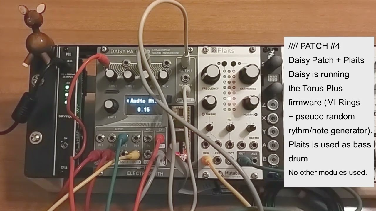

This is a small test of CV2 as “bass line” mode (daisy+plaits):

Another test with the latest version:
