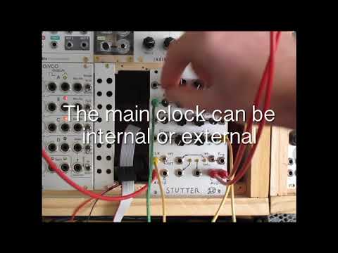

Hi,
it’s juste a small example, with a daisy seed into modular synth.
This is a stutter effect, stereo, all CV controlable.

There are 2 way: internal = simple regular trig.
Or external signal: in this cas, I’m using the Befaco Burst:
