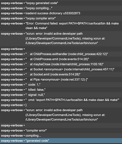

just installed and downloaded everything to get ready to try my new patch.init().
- connected it to my eurorack case,
- power the case on,
- connected the patch.init() with my computer
- pressed the boot and reset buttons
- hit the big button in the bpatcher
the bpatcher oopsy window looks like this:
tried also with other settings like 96khz.
the patch.init() led is off (only the power led is on).
I am running OSX 14.3.1 on an Apple M2 and max/msp 8.4.2
