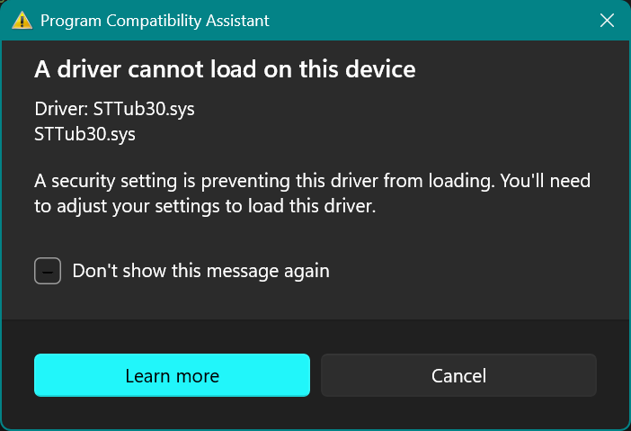

I sadly haven’t touched my daisy pod in close to a year but I’m trying to get back to it. I’m able to build everything on linux, but I’m having this error on Windows:

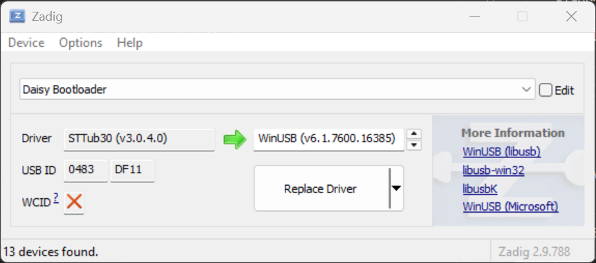

I’m using the Daisy Bootloader to boot from SRAM (as detailed in my post here), so when I connect the daisy it shows up like as Daisy Bootloader in Zadig:
Should I be updating that driver to the WinUSB? All the instructions I’ve seen were to update the DFU in FS mode device…

When do you encounter that error?
And I don’t think you need to use Zadig for the Daisy Bootloader like that as far as I know.
It looks like you may have to adjust something in the security setting.
I get the error right when I connect my daisy seed to my windows machine. Clicking on “learn more” brings me here, with instructions to “turn off the memory Integrity setting”, which seems pretty intense lol
I haven’t seen that error mentioned on the forum nor discord before, so I’m not sure what’s causing it unfortunately.
If you ignore that message and try to flash, does it work?
