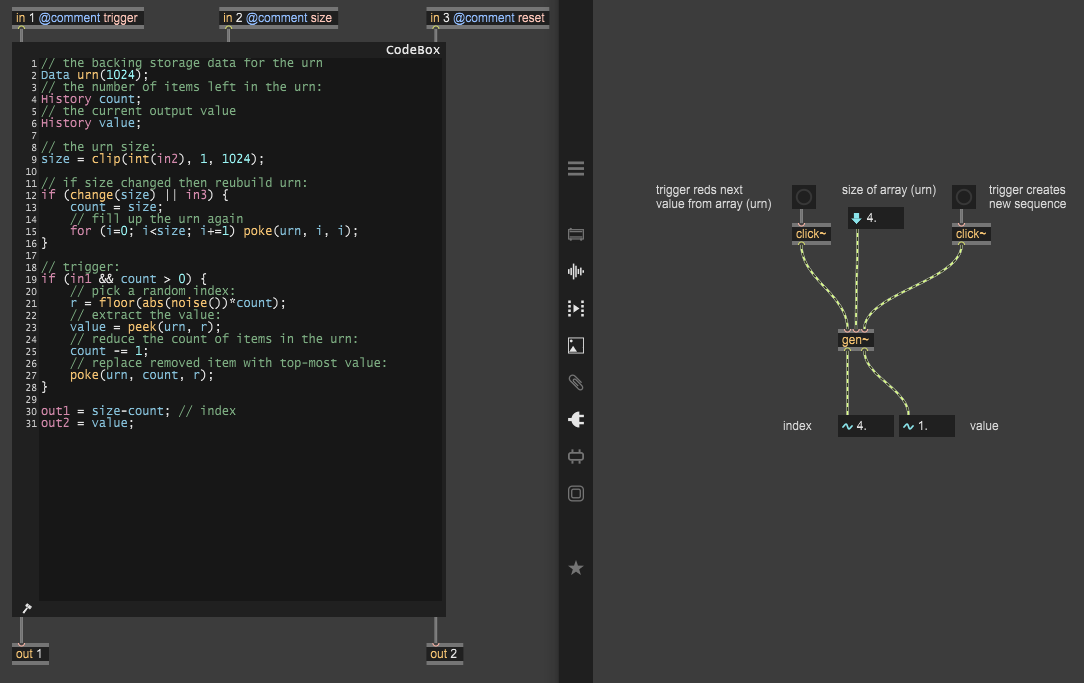

I would appreciate some advice, I’m trying to create something as simple as step sequencer with randomized step order. I know how to make it in MSP in a couple of different ways but somehow can not achieve correct result in gen~.
I found this nice example of making urn in gen by Graham Wakefield and tried to modify it to output value and index pairs. I want to use it in conjunction with poke to populate data from which I could just read in a loop using peek and counter.
What I want to achieve: e.g. when size is set to 4 I want to have indexes 0, 1, 2, 3 appear on the first output (index) and some random order of those values, e.g. 3, 0, 2, 1 on the second output (value).
For unclear reason for size 4 right now I get indexes from 0 to 4 and usually one of the values will be repeated or even occasionally a -1 will appear.
See the code

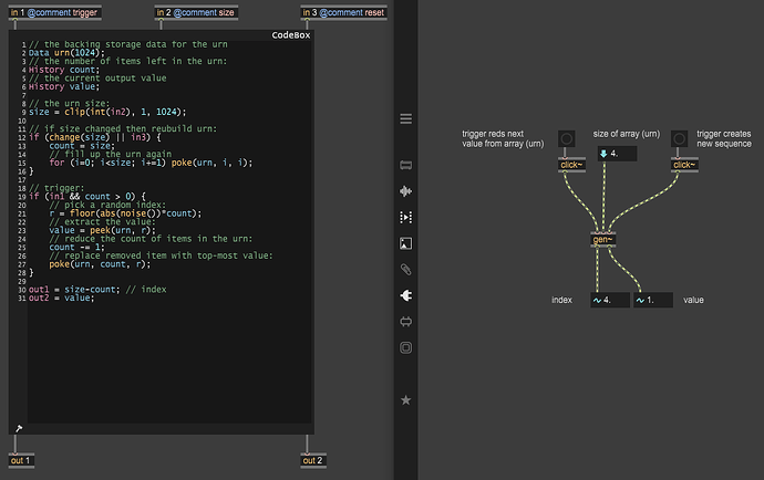

Ok, this really bothered me. I even came across almost identical example of urn in Gen in one of the tutorials
I’ve finally narrowed it down to the single-line for-loop used for filling up the urn that did not work :grimacing: and it was further confirmed by inspecting the code using the code tab in the gen~ patcher window (where this whole line was missing).
Simply adding brackets fixed it :upside_down_face:
