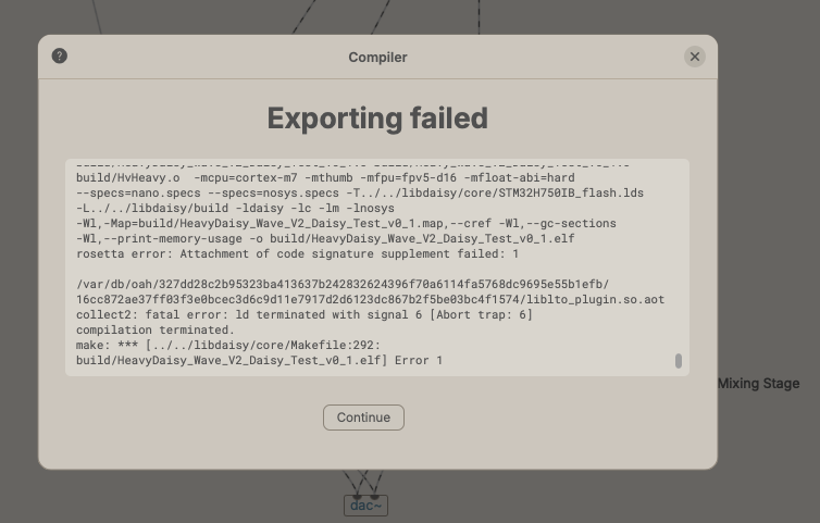

I am working on a guitar fx project with the daisy seed using plugdata and am trying to flash to the seed. I have written a custom json file for 2 pots and one switch. When I try to flash the code this error appears:
Since it looks like it is likely to do with the json file, I will put it here:

I don’t see an error, but I recommend that you update to the latest Plugdata (0.9.3) first so that we can see better output in the compile window.

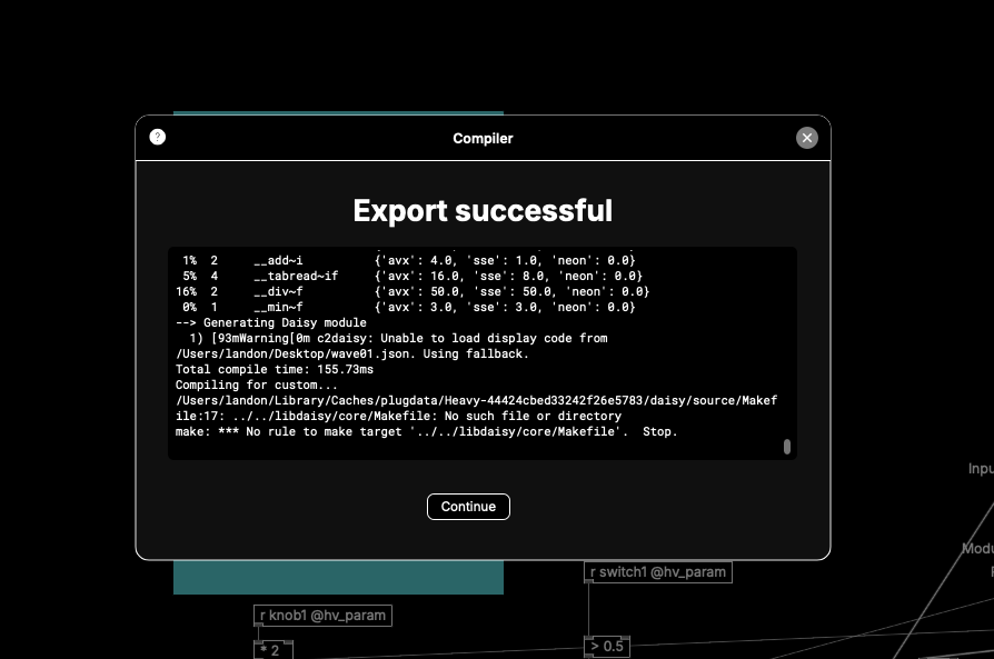

I updated to the latest version and ran it again. The export failed and the same warning from before appeared. I am still new to daisy and code/compiling so I don’t understand much of what is happening in the compiler, but here are a few moments that seemed worth noting
the line “Wno-missing-attributes” followed by “-fasm -fdata-sections -ffunction-sections” the showed up a lot in the compiler at various points
this warning also occurred:
HMessage.c: 173:55: warning: format 'IX' expects argument of type 'unsigned int', but 0 argument 4 has type 'uint32_t' (aka 'long unsigned int' ) [-wformat=]

This was the failure message:
thanks for the help thus far!
You’re using a Mac, and that looks like a Rosetta error - have you installed Rosetta?
I’d open a Terminal window, and try:
softwareupdate --install-rosetta
You can completely ignore any warnings, they are just that: warnings
More details about your OS and setup would certainly be appreciated.
