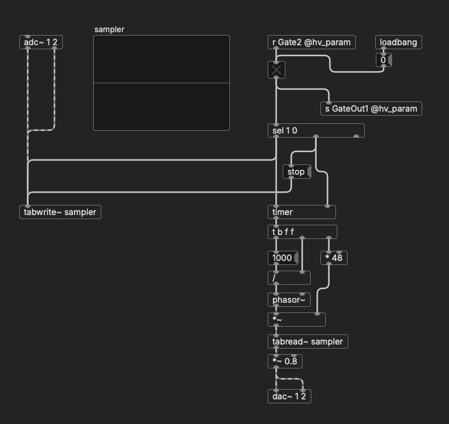

Little by late to the party I guess :sweat_smile: but I got the same problem with exactly the same patch with a Patch.init() module. I’m also using the graphical array and Huge/QSPI flash but when I send a trigger to the gate2 input (tried both Gate2 and Gate2_trig) I get no sound. The module is working fine with other patches and I’m using a gate output connected to an LED just for a graphical response of the patch; the led lights up when receiving the Gate2/gate2_trig pulse.
Do you know what I’m doing wrong? I’m quite a noob with PlugData, how can I change the array size?
Thanks a lot!
Screenshot 2024-05-31 at 10.30.43
Just click on the array and edit the size in the sidebar:
2024-05-31_10-51

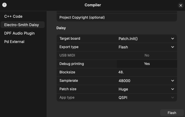

Thank you, I’ve read your suggestions. I’m joining the thread since I’m trying too to make a simple looper using the Daisy Seed with a Pure Data patch, and I experience similar issues with array dimensions.
When I select “Huge” in the Plug Data compiler, everything works fine, as long as I put in my patch an array of size under 60000 or so. Beyond that value, I get no sound - but I just can’t understand exactly what happens, since QSPI memory usage is still under 5%.
If bigger sample sizes require the linker files you mentioned above, I would not know how to select them from the Plugdata compiler. Should I use the pd2dsy method?
In the latest nightly builds you can also directly select variations using SDRAM.
These dynamic tables do not show in the flash size, since that only includes the compiled program.
The dynamic tables are allocated dynamically (hence the name) when the device boots.
Using the SDRAM flash options the 64M SDRAM is used for this, which allows for larger tables for loopers, delays, reverbs, etc.

I downloaded the latest nightly build and found the other compiling options.
With the “Big + SDRAM” option I can go up now to 120000 array points in the patch, then the compiler stops due to SRAM overflow. This is 2,5 seconds of sound, so this seems the max limit for embedding an array directly into the patch.

Ok, thanks ! Just some more questions:
  • why is it that the Huge (QSPI) option overflows SRAM way before filling up QSPI? At 8 % QSPI the SRAM is already in overflow (see image attached).
