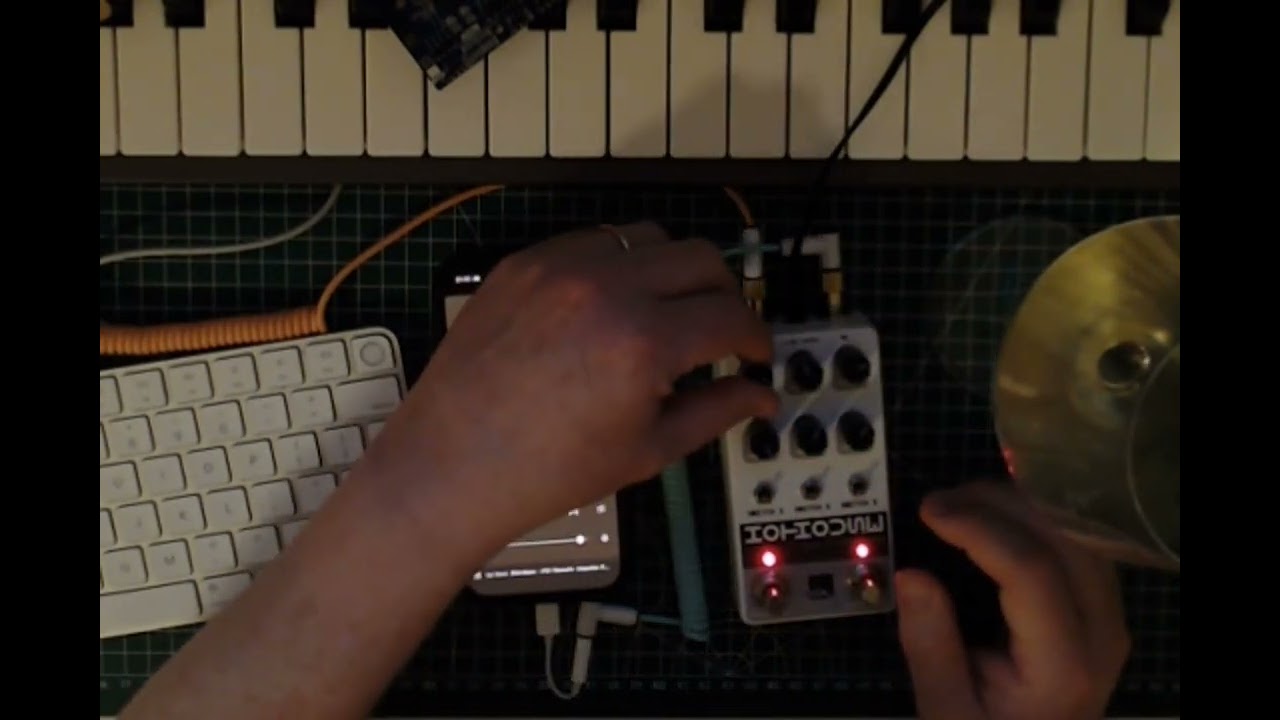

PSXVerb - Playstation 1 Reverb for Hothouse
Another fun pedal implementation, using the reverse engineered PSX SPU’s reverb specifications, in pedal form.
