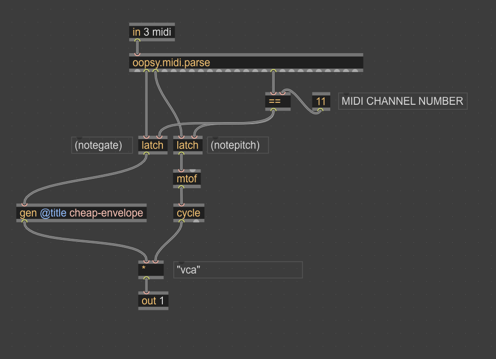

i am prototyping a daisy seed midi synth for eurorack. The hardware midi input works and everything but i like to “filter” somehow the incoming midi to one channel.
I use a sequencer with like 6 midi channels sending at the same time.
oopsy.midi.parse pick all of them up, how can i implement a channel selection in the gen~ patch, so the daisy only responds to midi channel 1 (for example)?
i am using notegate, notepitch and velocity from oopsy.midi.parse. so far.

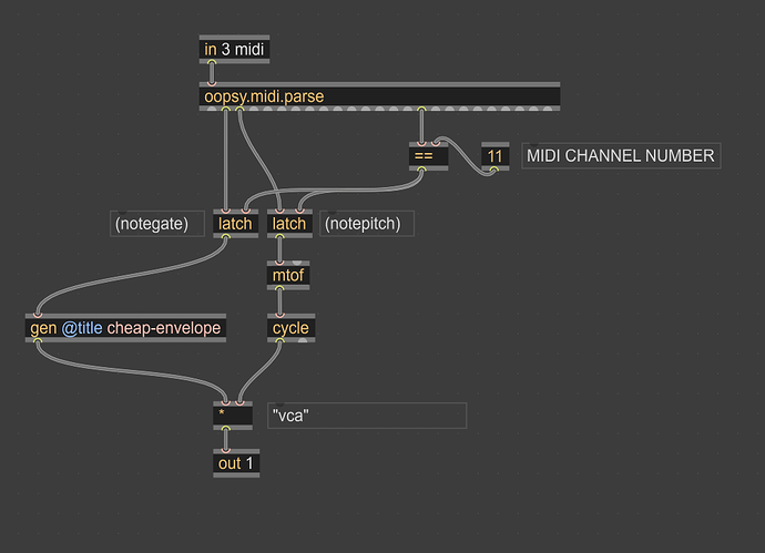

ok solved, just in case anybody else is wondering, this works:
like this only the gate and pitch from channel 11 (in this example) is coming through.
even if other channels are playing too.
of corse one can type any other desired channel number or make this externaly selectable, i guess.
…hmm under certain circumstances the patch on the daisy plays notes fom other channels when a note is pressed.
so maybe is there a better way to filter out all but one midi channel with oopsy.midi.parse
maybe the genius @grrrwaaa knows it?
