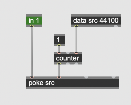

this is how my data/ poke and counter look.
Bildschirmfoto 2024-06-21 um 14.54.58

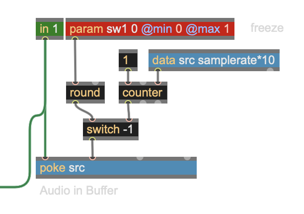

you mean the freeze of buffer?
yes. if freeze is enabled you set it to write to -1, so your before filled buffer stays the same.
