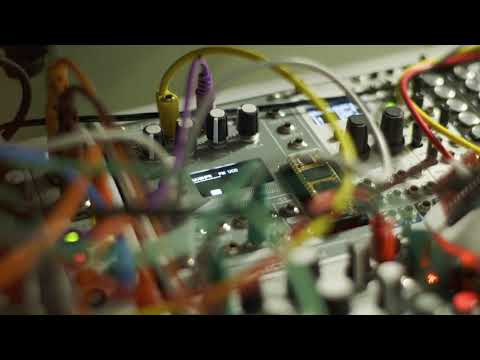

Olearia
A collection of applets for the Daisy Patch.
Mode Control Audio In
VCA Level Signal
VCO Pitch
Noise Level
VCF Cutoff Signal
All outputs direct through the audio outs.
Switch mode using the encoder. Hold the encoder and turn to navigate between applets.
CODE: https://github.com/CarlColglazier/Olearia
DOWNLOAD: https://github.com/CarlColglazier/Olearia/releases
