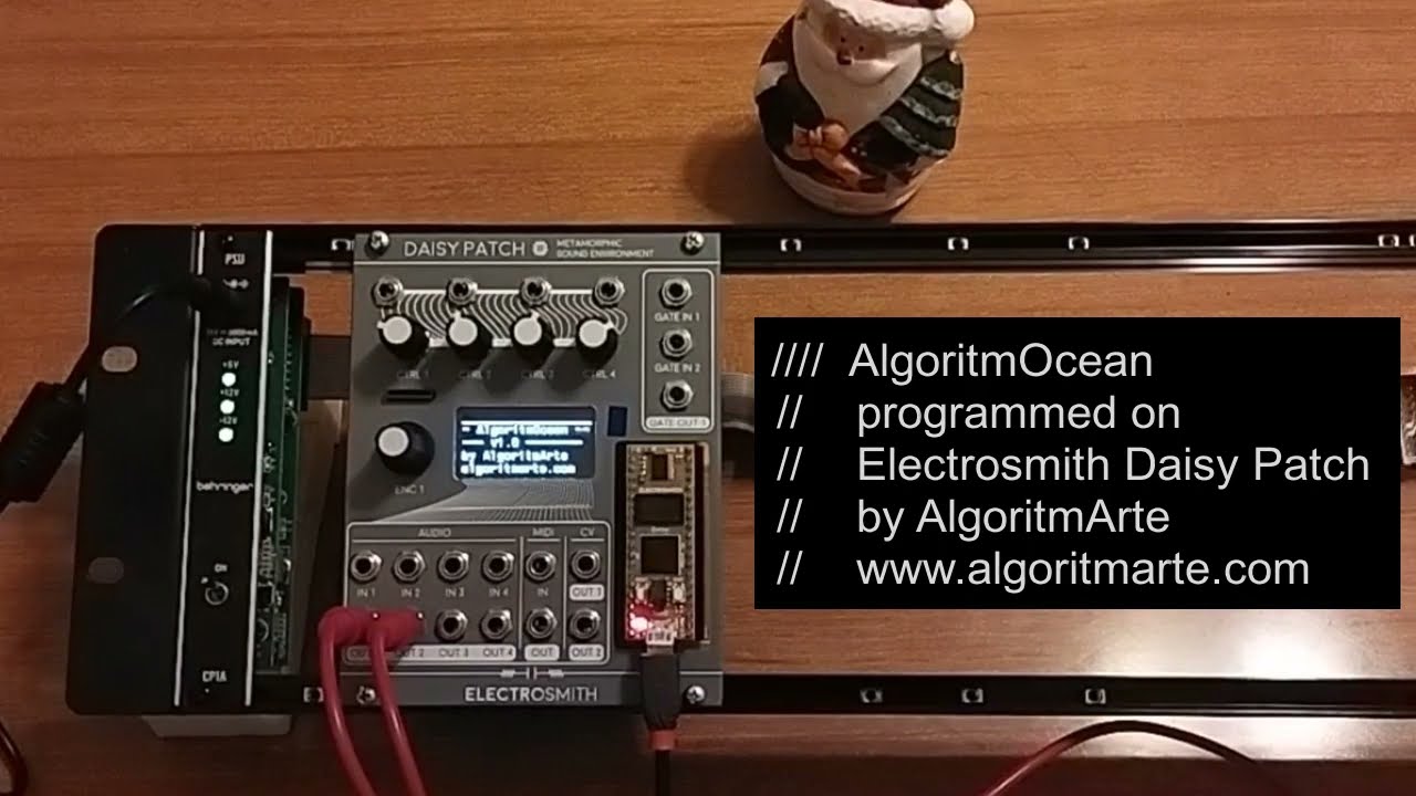

I’ve been experimenting with the Daisy Patch for a couple of weeks now and it’s a GREAT (and powerful) piece of gear!!!
This is a quick video (the code is still a mess, but I’ll clean it up and publish it soon):

Very nice. Do you have some information how you the ocean sounds were made? What kind of noise, filters etc?
There are three waves (one “far” - two “near”). Each wave is an Attack+Decay+pause envelope on a Pink Noise generator + LP filter (with a lower cutoff on the far wave). In the two “near” waves, when the envelope is reaching the end a new envelope on a White Noise signal is generated (to simulate the foam). All parameters (gain, AD stages, pan and cutoff frequencies) are slightly modulated with random values. I started from the information found about SyntherJack’s “Ocean Noise Generator” but didn’t find enough details about the exact algorithm, so I made some experiments and adjusted the parameters “by ear”.
