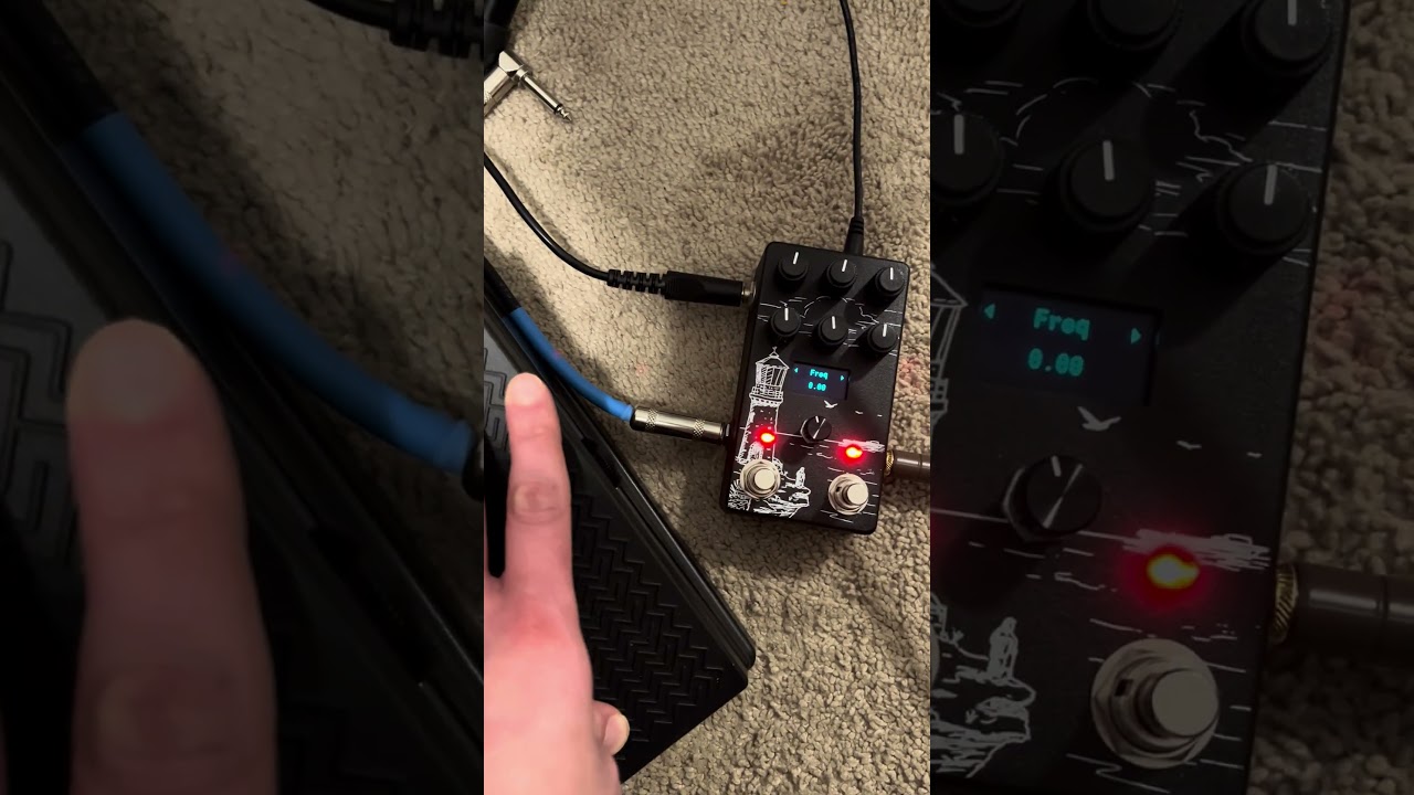

Expression unlocked!
Need to add this! Schemo?
I used the same circuit as the Funbox expression, and soldered to existing 3v3, 5v, and ground points, as well as directly to ADC 6 on the daisy seed. It looks like there’s room around the top right side for a smd version of this circuit, I was thinking about modifying the KiCad to add it and have 3 terminals to wire the TRS jack to.
I tried using the expression without the dual op amp out of curiosity, and just wired the trs jack like the other potentiometers. There is a good reason for using the op amp circuit! It seemed to work OK with the expression plugged in, but when I unplugged it the parameter I assigned to expression was randomly drifting, and not near 0, some point in between. The result was that the screen constantly displayed the value changing slightly. I don’t know the reason behind that, but you do need something besides just the TRS jack for expression.
