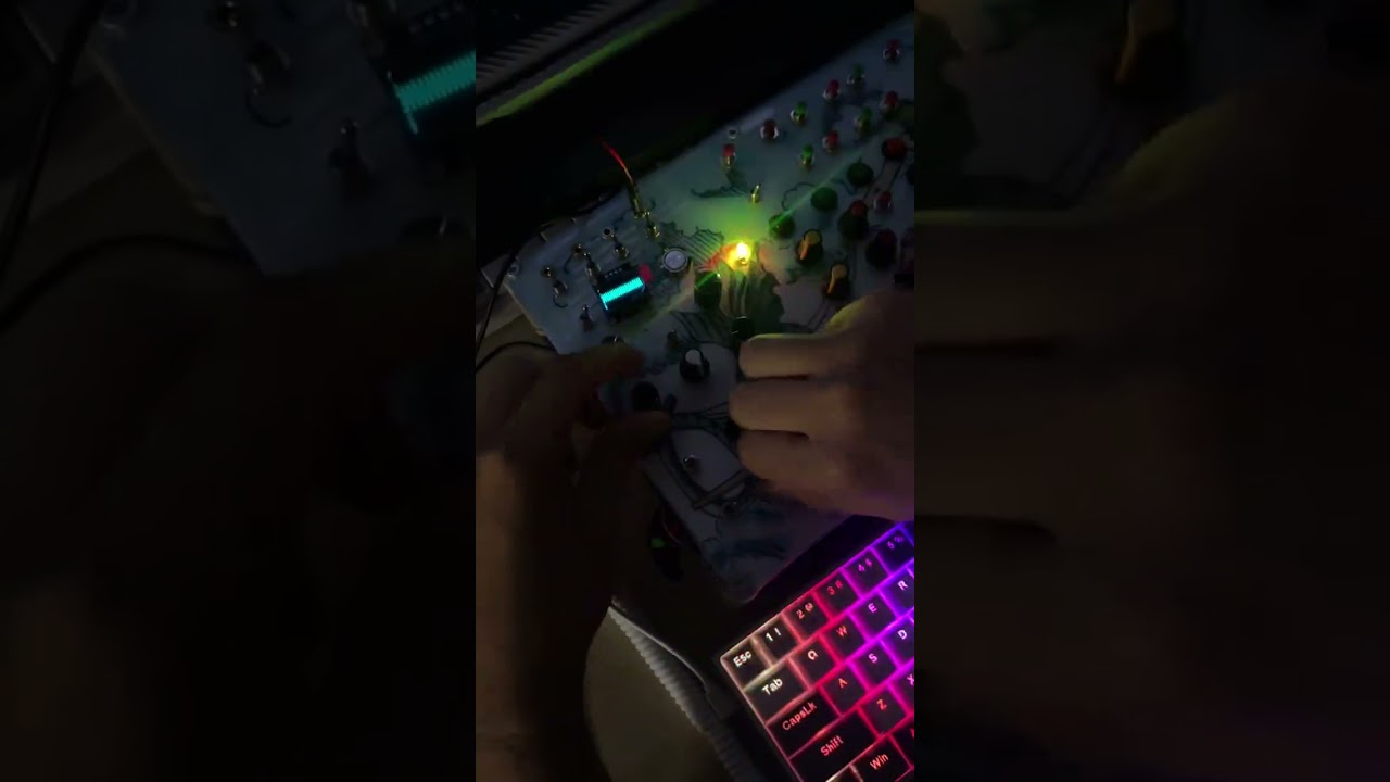

Hello there.
Although still in development, I wanted to share a project I did last year with Daisy Seed where i built a syntesizer foi a Media Art Performance. Full Performance Here!
Its divided in 3 parts: Oscilator, Efects and percussion, and it has a couple of diferent features:
-Master Mute Switch;
-Volume, Filter and Pitch knobs;
-Arpegiator mode with dedicated ON/OF switch and tempo Knob;
-Master reverb with dedicated knob;
-Delay knob with dedicated switch to turn the efect on and off;
The percussive part is stil in development. By now it features a clicky sound with a dedicated ON/OF switch and knobs for tone and Pitch.
The Screen has 2 visualization modes that you can alternate with the button. One show the full audio spectogram of the master output and the other one is a waveform visualiser that shows only the waveform being generated by the oscilator.
Each one of the 3 section has an LED associated so you know witch modules are currently working.
Im open to sugestions!
You can see it in action in a shorter video here. Enjoy :wink:

Sounding amazing!
What kind of sybthesis do u use?
Its a Simple Sine wave
