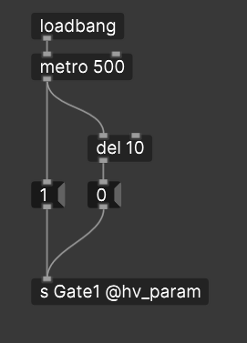

The metro outputs a bang, but the Gateout wants an actual 1 value.
What I’ve done so far is setup a very short automated 1/0 message event like so:
This will immediately set a 1, then 10ms later back to 0.
You may need to tweak the delay time to what suits for your specific setup.
Thanks Dreamer! i will give that a try and see how it goes
The patch works!
