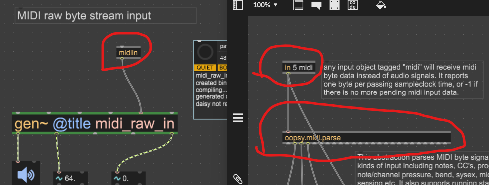

Another thing! I can’t debug Midi inside of Max…
Because, if I put an midiin at my max file, and connect it to the gen~ patch, this midiin is not in the same format as the oopsy.midi.parse expects. I believe Daisy Seed expect midi between 0 and 1. But the “midiin” give me higher values. Using scale does not seems to work in this case too.
