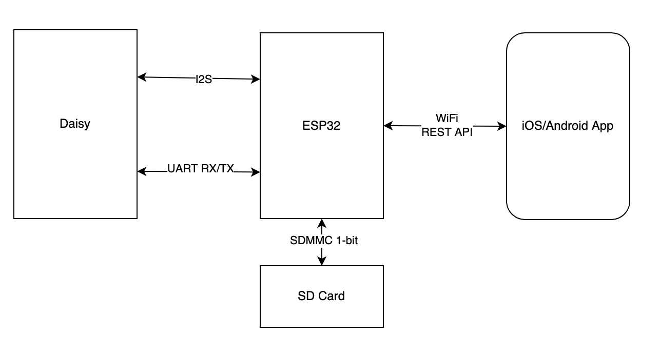

Next step - get Mars working on my custom firmware, the only additional processing the second I2S feed of the output stereo audio to the ESP32 for it to be saved to the SD Card.

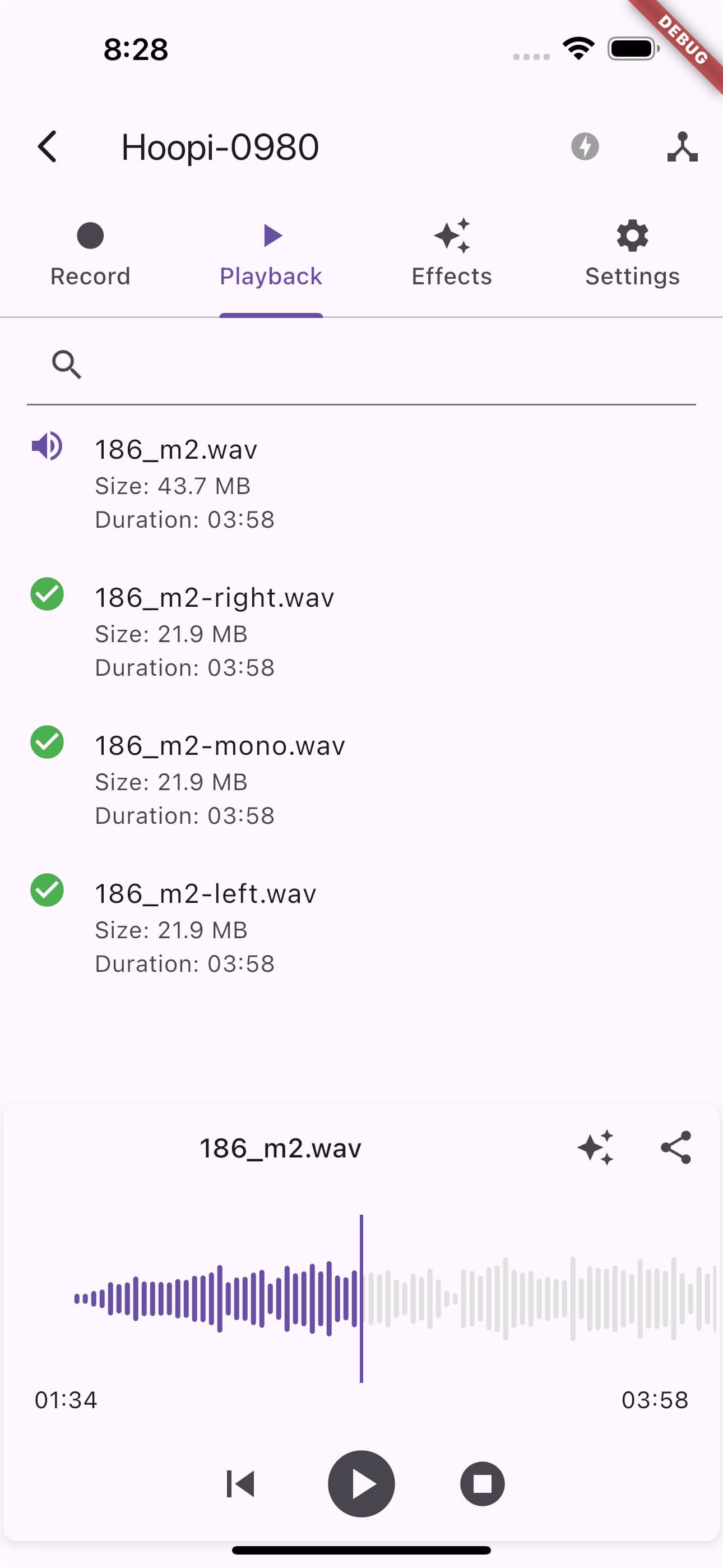

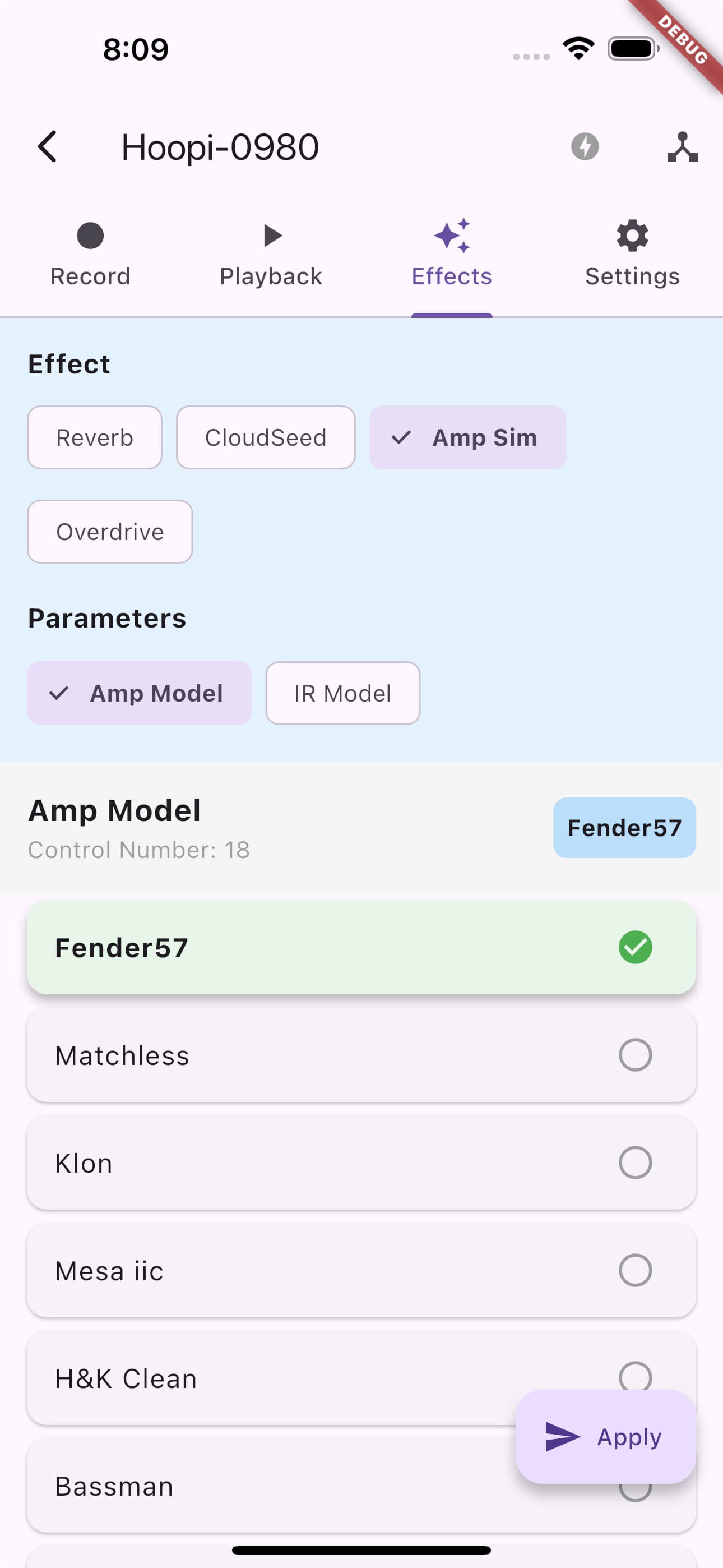

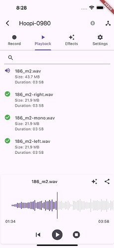

Thanks for the recommendations. I am very comfortable with mobile app dev (native and cross-platform) so I am going with Flutter.
The main USP of the pedal is the ability to record to an SD card and then download it to the app.
Recording can be triggered from the app or by pushing on FSW2. 1-bit SDMMC works fine for recording 2-channel 48kHz 16-bit samples, in fact even SPI-based SDIO works as well. My main challenge was the download speed from the SD card to the app via WiFi, the PCM WAV files can get large very quickly. I have managed to improve that from unbearably slow to bearably slow :slight_smile: (PSRAM buffer and menuconfig tweaks to the TCP buffers). I need to try the same with BLE to see if that gives a speed boost. I am using the XIAO ESP32-S3 module for the flexibility to use an external antenna. I don’t have a requirement for A2DP streaming, so I am ok with the S3.
I have some queries on JamMate. How are you communicating between the Daisy and the ESP32? I didn’t see any signals between the two in the schematic. I see you are using separate LDOs for the Daisy, ESP32 and the buffers. Is that for noise isolation?
Cool UI. Could not find the time to get into flutter, but I wish I did… ESP and Daisy talk via UART. Just sending 17 bytes from the app to the esp to the Daisy for each effect or config change,and the detected frequency from the Daisy to the esp in tuner mode for displaying the tuning error.
LDOs maybe an overkill as both Daisy and ESP have LDO but I guess you can never get too much isolation. Especially when the BL or high processing kicks in. I did get a noticeable hum when reading the IR and drum samples from the SD on boot. Maybe reading to the ESP is quieter but I don’t have any IOs left…
