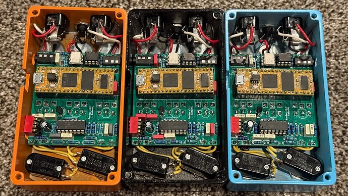

I built 3 custom Funboxes all at once. :slight_smile:

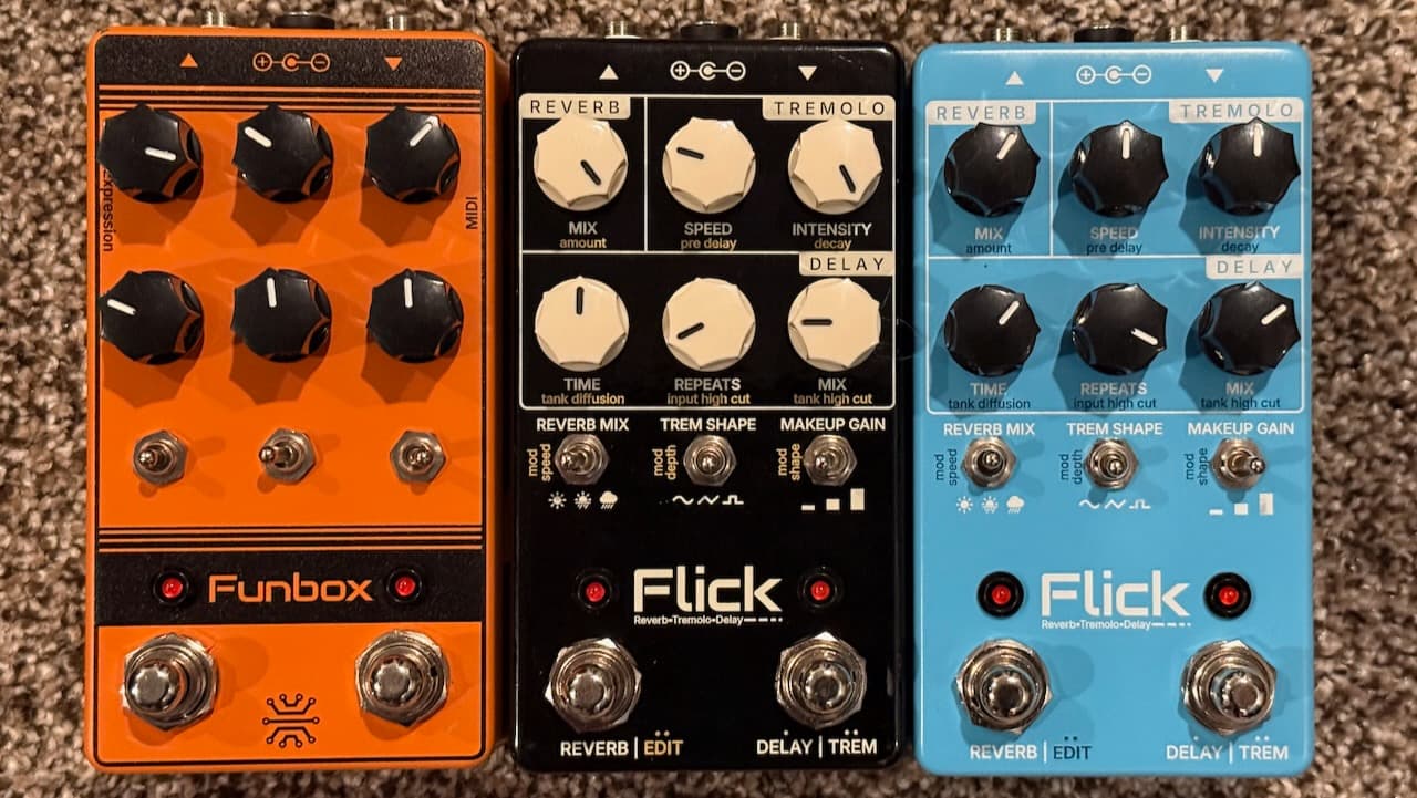

A few months ago I used the Hothouse pedal to experiment with getting a good plate reverb + tremolo + delay in a single pedal so it’d fit on my simplified nearlly-fully-DIY pedalboard (Ditto+ and my PS). Once I realized it would work well, I drew up some designs for a custom-built enclosure and used the Funbox to build up a couple of different versions of the Flick.
Yesterday I got the code working on the Funbox so it’s fully working on my board now. The left foot switch toggles the reverb and the right foot switch toggles both delay and tremolo separately (single tap for delay, double-tap for tremolo).
I wanted to build this to compliment my amp that has no built-in tremolo or reverb and it is working great! It’s also inspired by the Strymon Flint, but with the added bonus of having a delay in there as well.
Eventually, as I get time to work more on the code, I’d like to use the DIP switches on the side to make it possible to support other types of reverbs. I also still need to add support for the expression pedal and midi.
Once I get the code cleaned up and fully working, I’ll get it posted in GitHub.
Can’t wait to try out the Flick code! They look really professional, the symbols on the toggle switches are a nice touch.
Thanks! I’ve kinda got my code in a mixture of Hothouse + Funbox running on the Funbox hardware so I need to get that all cleaned up.
