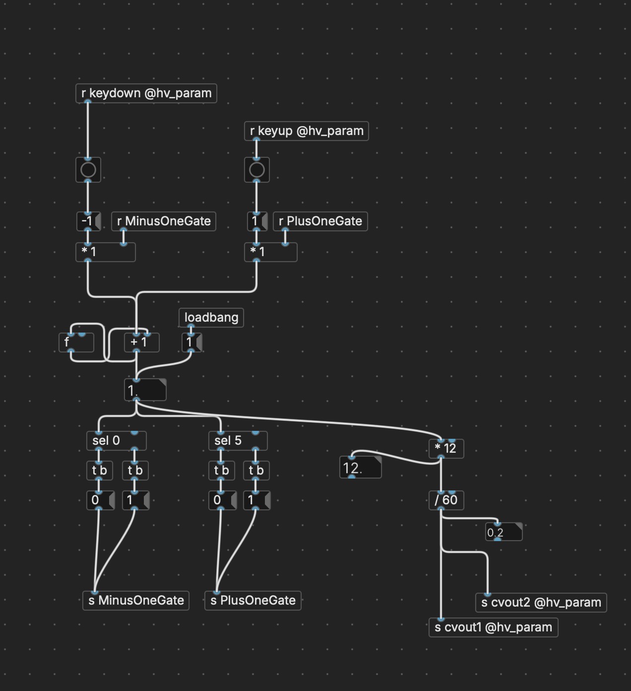

I have been working on a project for some time that now needs to be compiled in a bigger size than that small. The weird thing is that when I flash with the Small options it’s fine, it’s really just in Big or Huge that my patch is then unresponsive.
There’s no need to look at the patch in its entirety, only one of its sub patch is enough to see if the flashing is conclusive or not. Here’s a picture of it:
In short, I have on my breadboard two buttons, one that rises the level of the cv outputs, one that lowers it. I can see the levels rising on my breadboard with the help of LEDs connected to my CV output by using a TL072 in a buffer configuration.

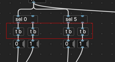

From this subpatch I can’t see anything peculiar that could cause issues with the bootloader.
Only these trigger objects that are redundant, because the select already outputs a bang:

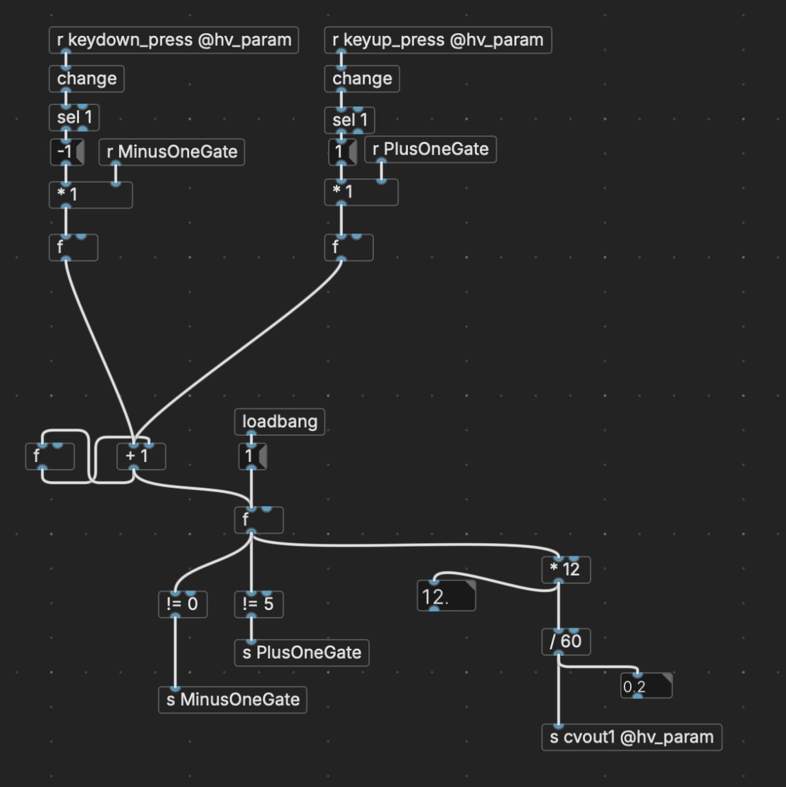

Yeah this doesn’t make no sense to me. I have just finished doing something a bit more robust with this circuit (it’s crazy how much you progress fast when you get into it) and I have came up with this:
I also confirmed with my oscilloscope that when compiling with the ‘‘Big’’ option, [keyup] and [keydown] are not floating at 3.3 V while waiting. Could it be a problem of big mode not compiling correctly the Json files? Here is a copy-paste of mine:
