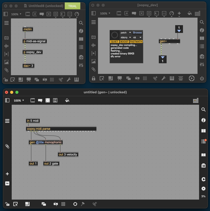

workaround that I’ve found is to edit my synth as an abstraction in a patch without oopsy and when saved, open up a new patcher with an instance of that abstraction and oopsy.
somehow if you then edit and save the original abstraction again the instance gets disabled, so you need to make a new patch with oopsy and the instance each time.
perhaps I’m missing a more obvious solution
ah yes this is the more obvious solution: put the oopsy in a subpatcher and have the midi signal come in via inlet.
This is super, thank you!
here’s a minimal development setup for it that I made and @grrrwaaa refined:
