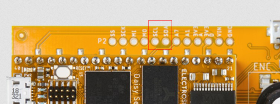

Forgive me, the SDL and SDA are clearly labeled on the pod after actually looking at the board myself.

Sorry, I didn’t fully read you want to use the Pod specifically. I think that you mean SCL and SDA for the pins, and those seem to be marked on the Pod here:
