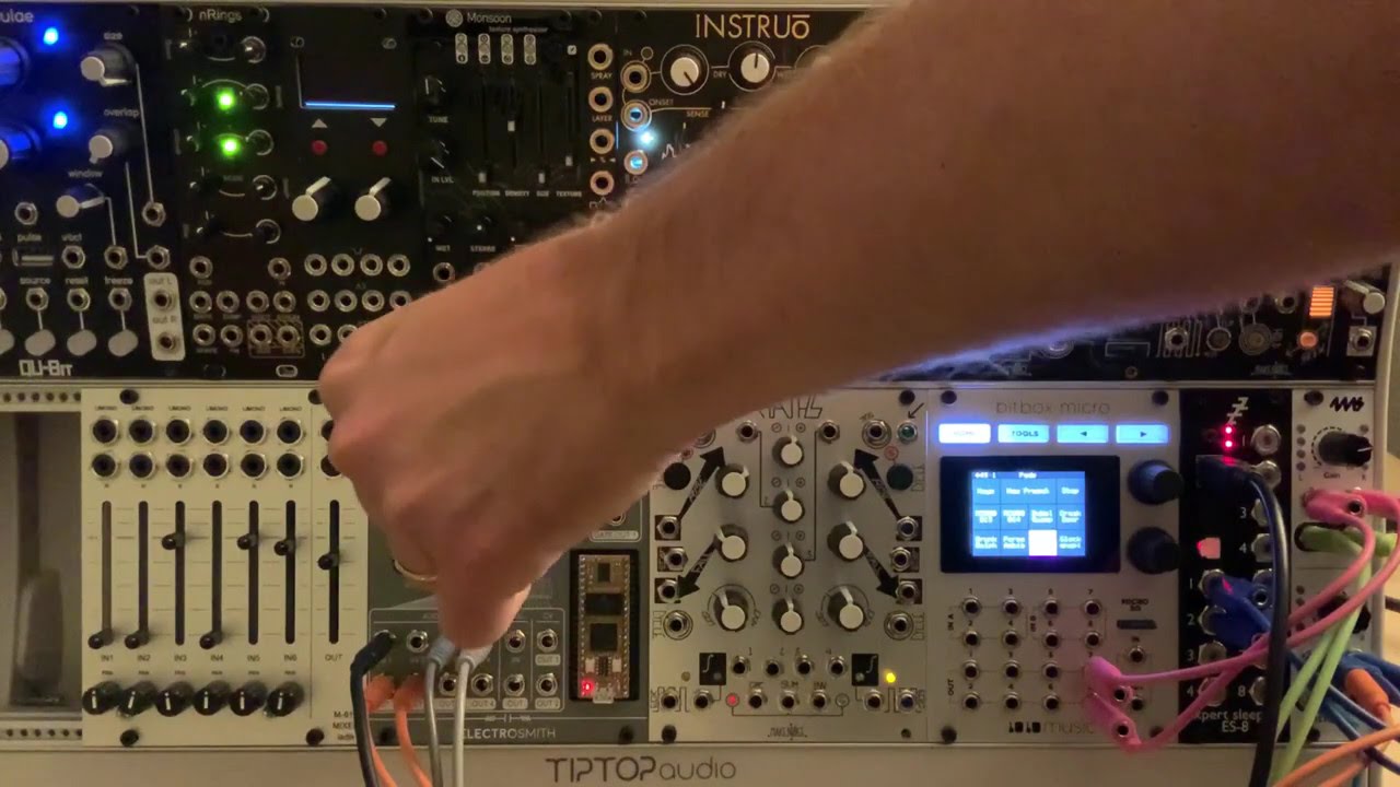

Here is a preliminary video of the reverb in action:
You can get the source and binary ex_cloudseed.bin here:

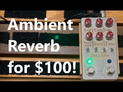

I recently discovered Cloud Seed and then your port to Daisy Patch, awesome stuff! I’ve been working with the Daisy Seed on the Terrarium hardware, which is a mono guitar pedal from PedalPCB. I was able to get CloudSeed running on it with 4 delay lines, using mono-only processing and it sounds awesome. All the presets work except “Through the looking glass”. I plan on open sourcing my fork of DaisyCloudSeed and sharing, and will probably make a video demo.
I’m not very familiar with reverb algorithms, but on the Terrarium I have two more potentiometer knobs and 4 on/off switches that I’d like to add functionality to. Any suggestions for which parameters to control with these to offer the most versatility? I’m currently using one stomp switch for bypass, and the other to cycle through presets.
Edit: I think I’m going to use the switches as selectable delay lines, 1 to 5, I was able to make it handle 5 lines on almost all presets.
And here is the finished version! I’ll be playing around with this thing for a long time, so much fun.
And the code:
