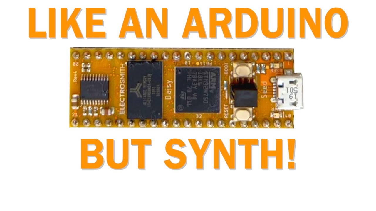

I essentially want to build this:
But with the pressure sensor from this to replace the distance sensor
In the future if this is even a viable idea, I would want to add two ribbons for playing harmonies or bass and lead lines, but for now just having the option to record and perform cello like synth sounds in the vein of a trautonium on the fly without a laptop is current fixation and I wont rest until it is complete somehow.
Is this a viable project? What are some things I would need consider? Like would connecting the pressure sensor in place of the distance sensor change anything in puredata? Or would it be the same process for daisy as the arduino?

Totally possible!! I was mainly using DaisyDuino in that video to demonstrate that Arduino users can get the hang of it smoothly :slight_smile:
I could have easily made a version where Pure Data (or plugdata if I were to make that video today) was used.
You’ll see potentiometer being used in lot of the examples, but you can use those sensors instead just fine.
Have fun!!
