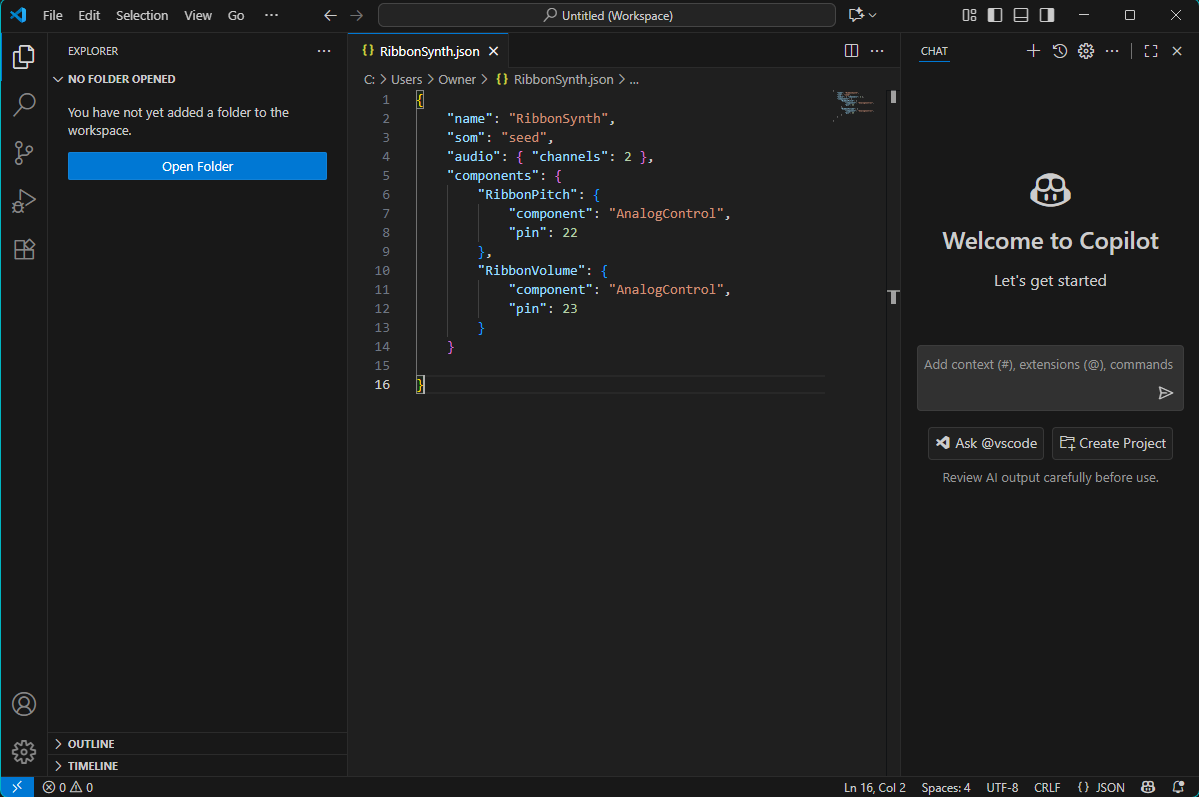

The Seed is what is called a “System on Module”. In order to target a device you have to design a “board” configuration that defines the components and names that you can use in your PD patch.
You can find more information on how this works in the documentation: Board JSON - Heavy Compiler Collection
(I’m still planning to do a video on how to get started with custom hardware)
Thanks for the help! I didn’t know I needed a json file for the seed!

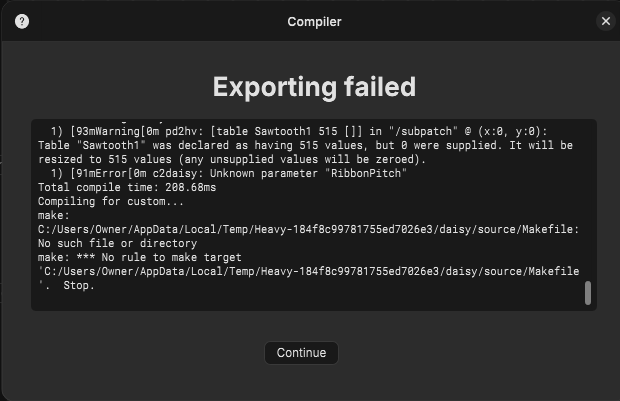

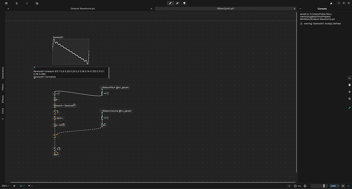

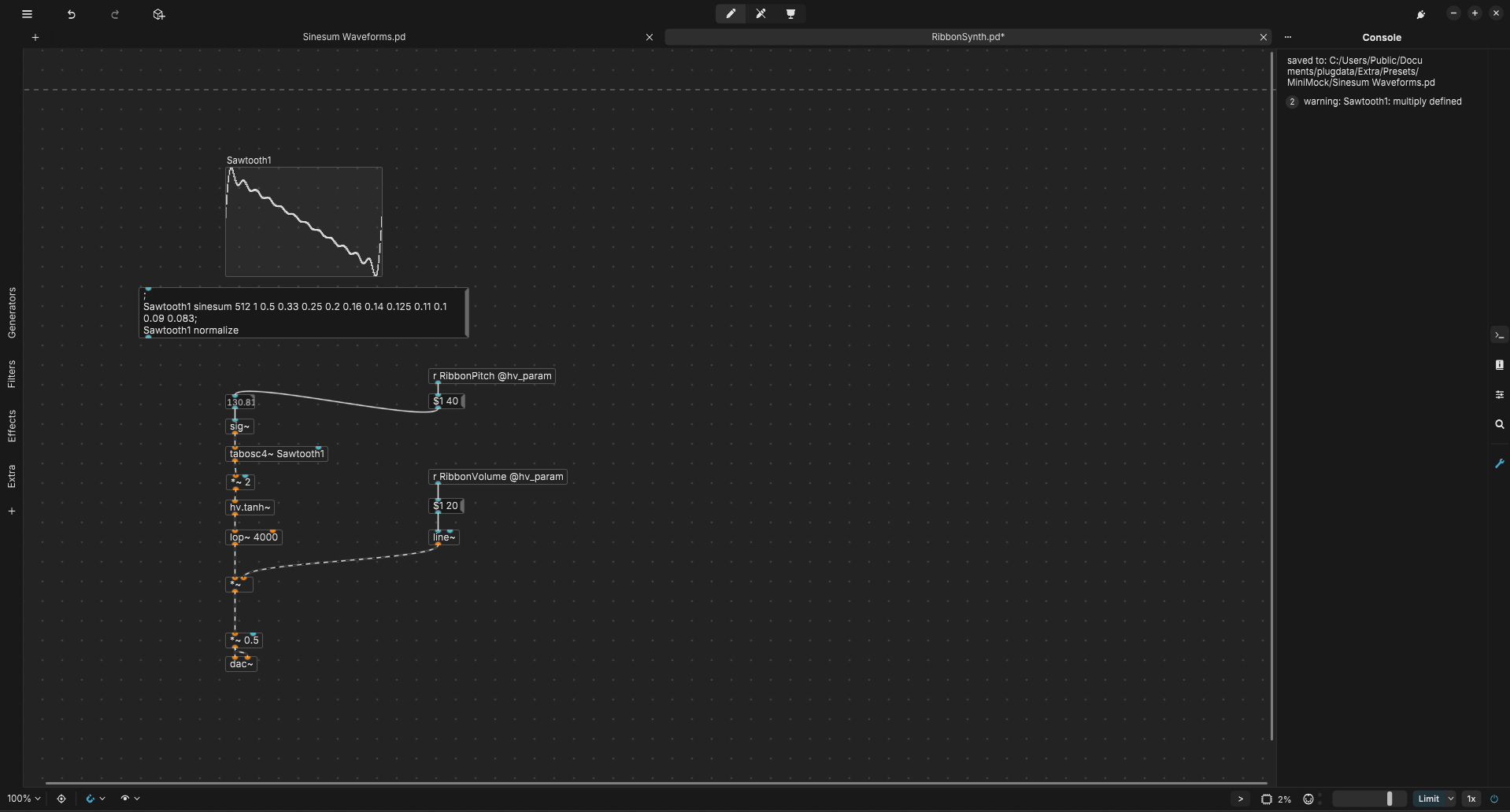

I followed the steps to the best of my ability today and have got a basic pd patch and a custom json file where I set up my two sensors to the best of my ability.
It seems I have done something wrong however, and I haven’t the faintest clue what it could be. I just learned about json today while putting it together so it would’ve been a miracle if it had worked first try I suppose. It doesn’t seem to recognize my parameters from the json file.
What am I missing here?
Oh, one sidenote here is that all component names are turned to lower case, so best to use just lowercase in both your patch and in the board file! (I’ve adjusted the examples and added a note about this in the docs)
Otherwise it looks good to me.

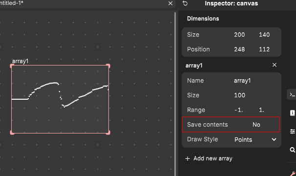

Btw, sinesum messages are not supported, so you should store the table data inside of the patch.
Export successful! Thanks again man!
Just no sound and I would expect the sinesum is the issue as you stated
Flip this setting from No to Yes:
This will make your patch bigger though, so you may want to move to Big or Huge flash settings. This will also install the bootloader.
