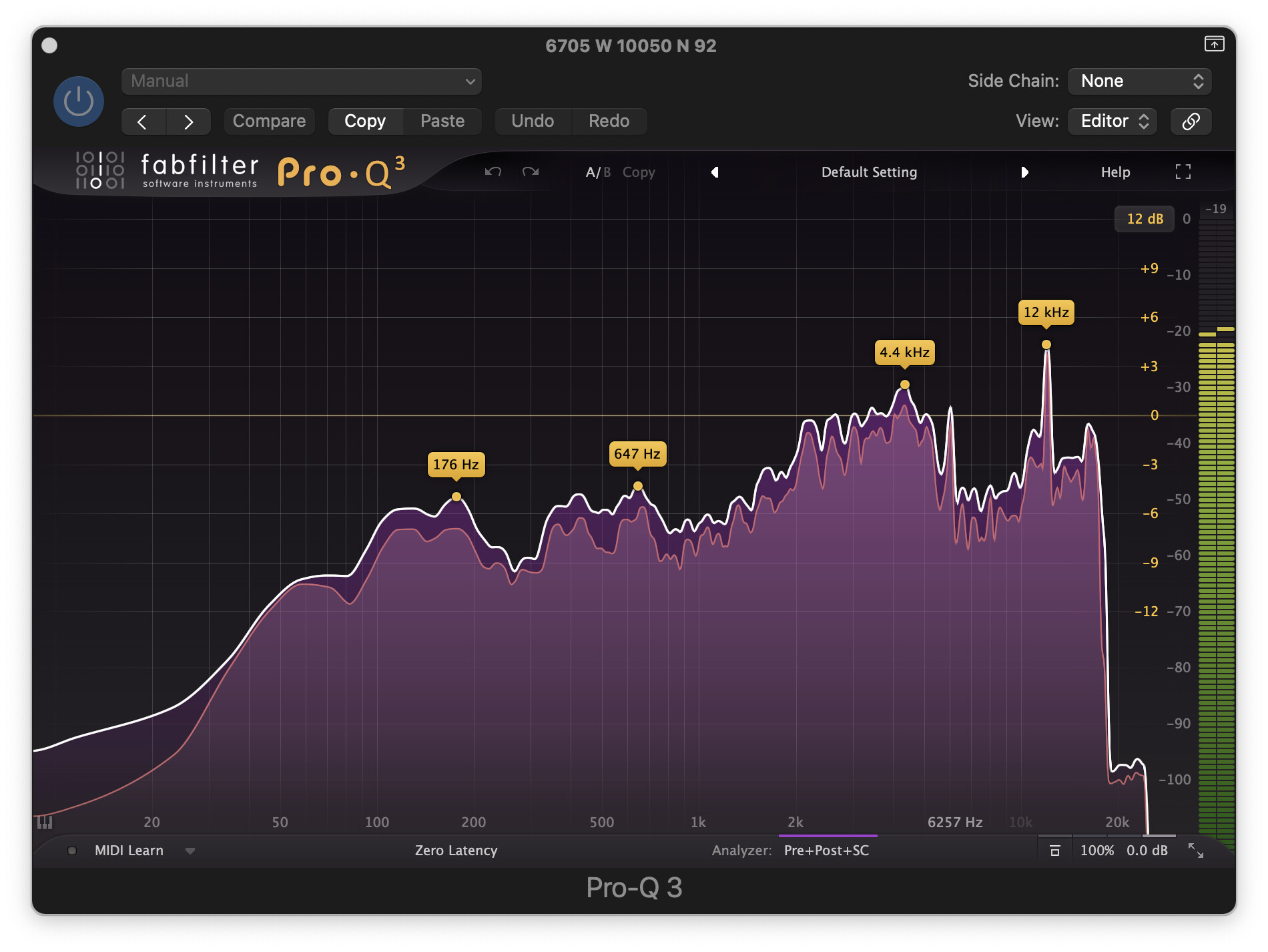

This week I was doing some other testing and cranked a couple of my tube amps to max and noticed an odd digital oscillation noise. When I loaded it into a spectrum analyzer (Pro-Q in Logic Pro), I noticed that it had a peak at 6 kHz. When I temporarily mod my code to be full passthrough (no DSP processing), the oscillation doesn’t happen.

Sure enough, it bumps it up to 12kHz.
Yeah, as I change the block size up or down, the oscillation moves the opposite direction.
