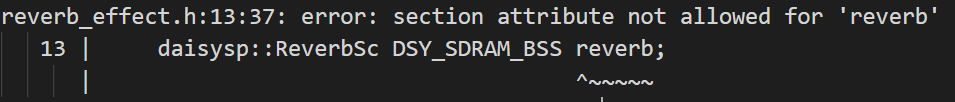

Thanks for the reply. However, I got an error when compiling.
I guess that’s because SDRAM is not yet supported in the Arduino environment?
Or am I doing something wrong here?
Ah, yes. I had assumed you were using the C++ environment and not Arduino.
We are working to add RAM support to Arduino, but it is not yet supported. Sorry about that!
