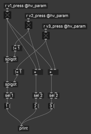

What behavior do you want when v1+v2+v3 is pressed?
I came up with this using the _press variant for switches/buttons:
But if you press all 3 then you get 2+3 on the output.

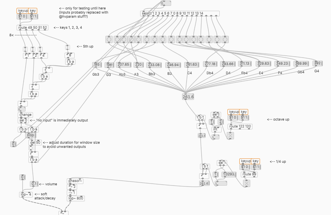

Thanks for the reply. I was struggling to get your patch to work the way I intended.
I ended up adapting a patch instead. Basically, the three valves output the eight possible values (including when no valve is pressed), and I added extra valves for a fifth, an octave, and a quarter-tone up.
