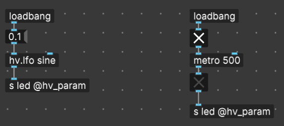

For instance this on the left doesn’t work, but on the right does:
(I just tested this and the left just keeps the led turned on)
