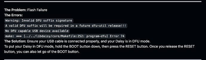

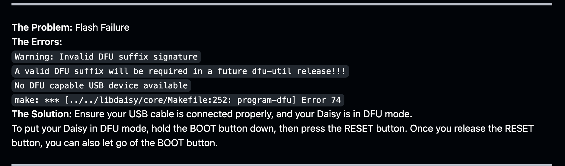

Warning: Invalid DFU suffix signature
A valid DFU suffix will be required in a future dfu-util release!!!
Opening DFU capable USB device...
ID 0483:df11
Run-time device DFU version 011a
Claiming USB DFU Interface...
Setting Alternate Setting #0 ...
Determining device status: state = dfuIDLE, status = 0
dfuIDLE, continuing
DFU mode device DFU version 011a
Device returned transfer size 1024
DfuSe interface name: "Internal Flash "
Downloading element to address = 0x08000000, size = 72004
Erase [=========================] 100% 72004 bytes
Erase done.
Download [=========================] 100% 72004 bytes
Download done.
File downloaded successfully
Error during download get_status
make: *** [../../libDaisy//core/Makefile:344: program-dfu] Error 74
* The terminal process "C:\Program Files\Git\bin\bash.exe '--login', '-i', '-c', 'make clean; make; make program-dfu'" terminated with exit code: 2.
* Terminal will be reused by tasks, press any key to close it.
I honestly dk what might be wrong here, since im new to cpp.
