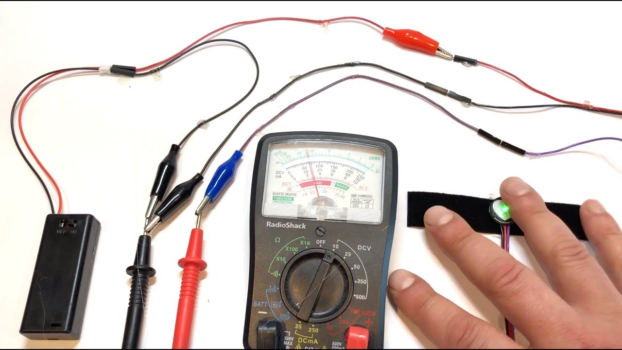

Looking at this video here
you could probably just use the sensor as a CV source. You’d want to build a buffering circuit between sensor and pin so you don’t accidentally damage the STM with too much voltage.

Buffer isn’t needed. All that’s needed (for hardware) is power, ground, and an analog input.
The PulseSensor is powered by DC voltage between from 3 to 5.5V.
The PulseSensor output is in the range 0.3V to input voltage.
