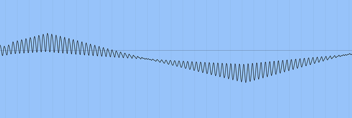

I’m building a little tracker sequencer thing and when I playback audio I get this weird buzzing sound that happens that looks almost like RM through zero. When you zoom in on the recording, the period of the buzz is roughly 4 samples which is my buffer size. I am fairly certain that my code is not the issue as it is just an oscillator and an envelope being triggered on and off.

You should be able to share an audio file. I would like to hear what it sounds like.

What is RM through zero?
Since you mention some apparent correlation between the noise and the buffer size - have you tried other buffer sizes to (possibly) find out if that is a coincidence?
