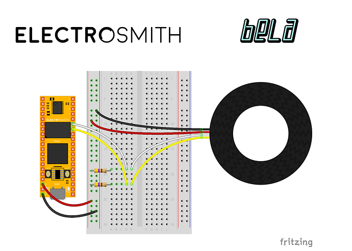

I am trying to get the daisy Seed working with the trill. I can’t get any input from the trill. I am using pins 12 and 13, acknowledging that their diagram is incorrect. I don’t get any recognition from the trill. I have it set up with the resistors. The sensor is getting 3.3v, confirmed with a multimeter.
If i run the hex-print sketch, there are no errors so it is recognising the tril but it is not recognising any touches.

The Trill sensors have not been merged to libDaisy yet. So are you using this branch from giuliomoro?
If so it would be best to give feedback there so any issues can be fixed first.
According to your other threads, it looks like you’re using DaisyDuino.
If so, yes, Trill should work with that :slight_smile:
