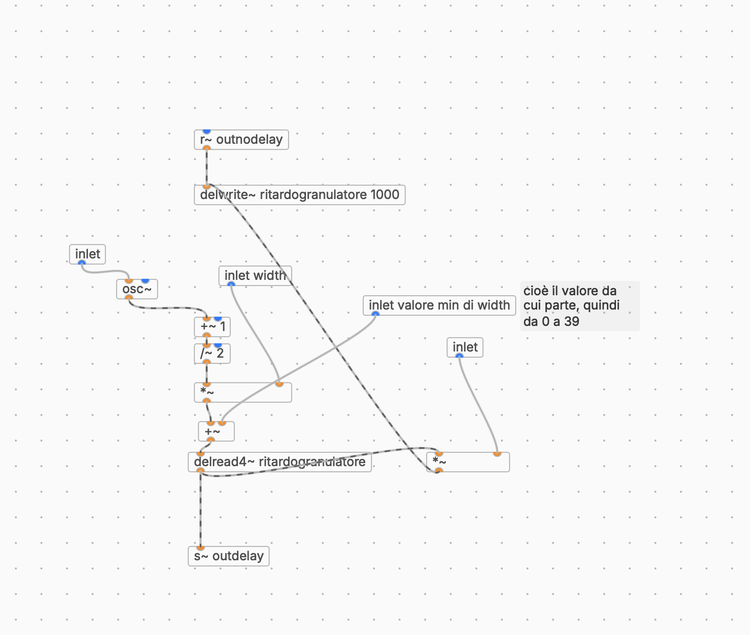

I noticed that the problems are related to this “delay.”
If I connect a potentiometer to the first inlet, I have no problems. However, if I connect one to the second inlet (inlet width), I hear nothing. If I connect a potentiometer to the last inlet (which adjusts the feedback), I hear audio, but other controllers that adjust parameters of the main patch no longer work.
Try using signals (orange) instead of control rate messages (blue) on these objects.
Daisy potentiometers send new values once every audio block which can “reset” objects. If it’s a continuous signal (for instance using [line~]) then usually there are less issues.
Also try building with only this delay and nothing else, so you can investigate with less variables and more focus.
Thanks a lot, I also noticed that increasing the blocksize in the compiled mode menu helps. I used to have it at 2, now it’s 48 and it seems to work correctly. Does that make sense? More than anything, I’d like to understand why.
If you have it at 2 and are doing a lot of control rate calculations the CPU may not have enough time to finish everything.

yes that was the problem, now everything works correctly, thank you very much
