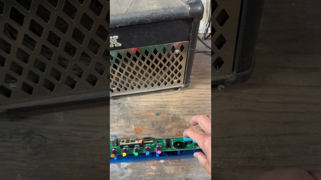

It’s always there regardless of the code, even for a test code making a simple tone. It doesn’t appear to be originating in the power supply (I’ve used several different ones and it’s there for all of them.) It isn’t coming from the onboard amp because I’ve run a signal through it from a function generator and it comes through clean. It’s definitely coming from the Daisy board. I’ve made it much less noticeable by cutting the output down with a voltage divider before sending it into the amp through a follower. It sounds sort of like a phfttt phfttt phfttt sound at around 10 to 20 hz.

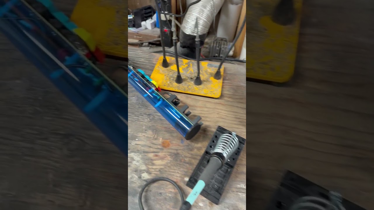

Hi Takumi, Here are links to a couple of short videos that show what I mean by the pfft-pfft background noise I’m trying to eliminate. Thoughts?
