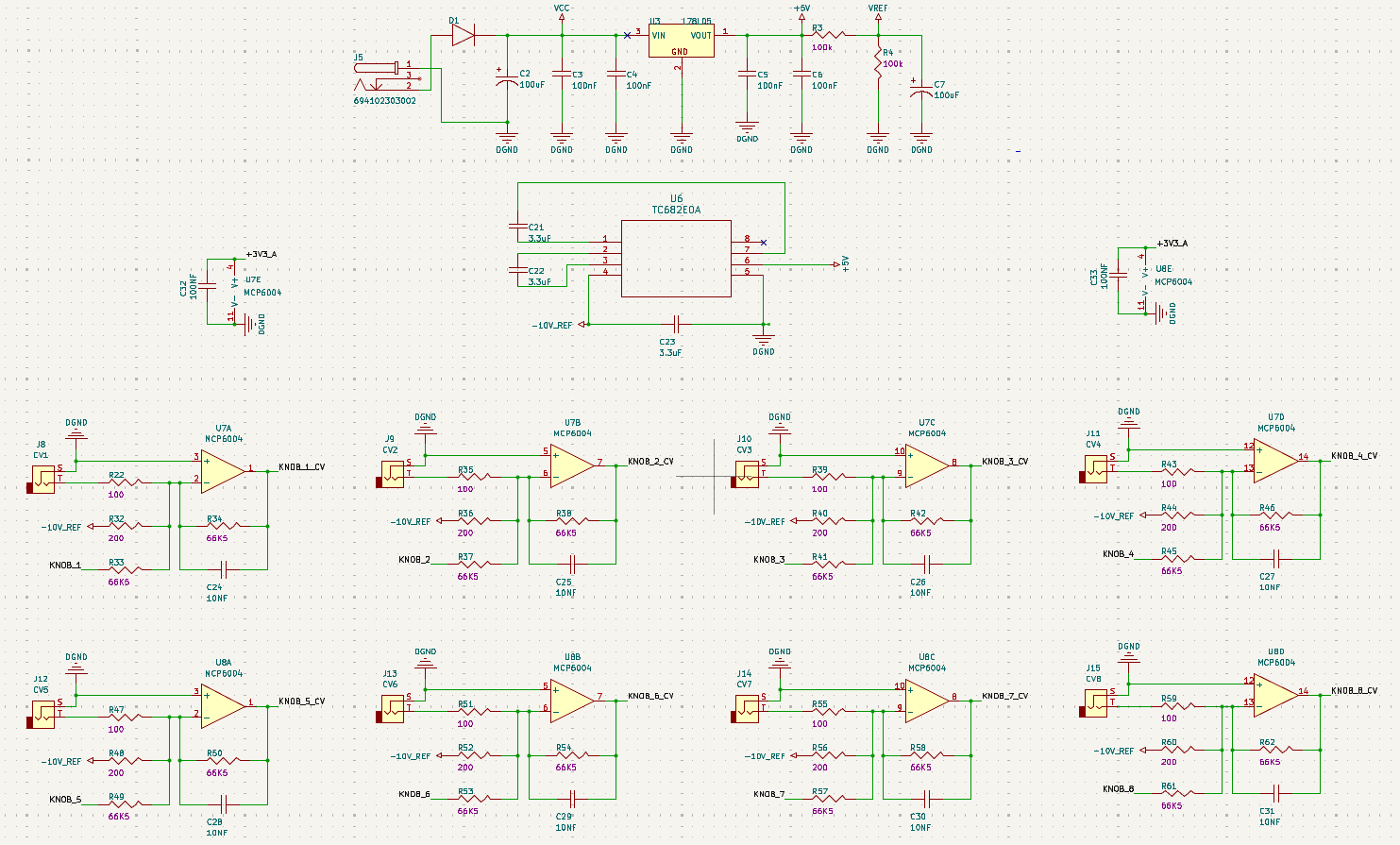

Adding CV control to a 9v Guitar Pedal
I’m trying to follow the daisy patch schematic for CV input, but since it’s a guitar pedal I need to modify it to work with a 9v power supply. I’ve sent my 5v reference voltage to a inverter/doubler, and used that for the -10V reference. Does this seem like it would work to you? Just wondering what you guys think before I order parts…
