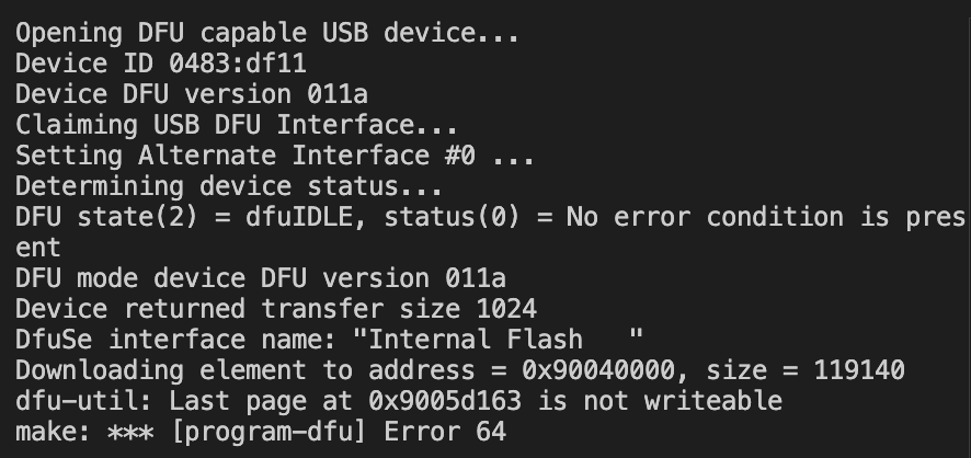

I also caught this issue and still can’t solve it in my project. Would be happy if anyone can help.
I’ve done all the steps to fix:
  • through the steps from the PR, got success in serial output
  • updated libDaisy submodule, rebuilt it
  • via Daisy web programmer flashed bin with new bootloader in libDaisy/core folder (v6.3, external, 2000ms)
    After, press->unpress Reset, press/unpress Boot I have glowing led.
After trying to flash my project with build_and_program_dfu I still have the issue
In makefile I have
APP_TYPE = BOOT_QSPI
When use APP_TYPE = BOOT_NONE everything works as expected, but I’m about to out of memory so need the external FLASH.
So, to me it looks like the program is trying to flash internal memory, despite the fact that all (not sure at this point) set for the external one. Probably I missed something

I’m having errors myself now trying to keep the main program in FLASH, but store some larger arrays in QSPIFLASH, I alway get dfu-util: Last page at 0x90087333 is not writeable errors.

@Xavier2069 it didn’t help, unfortunately.
I reproduced steps described here, and I see glowing which means boot loader is flashed successfully.
Also, I re-cloned DaisyExamples repo with all the submodules to be sure everything is up to date. No changes..
Did you flash while it was doing the slow glow?
By the way, you can extend the grace period indefinitely by pressing the BOOT button as oultined here Daisy Bootloader - Daisy.
During that grace period (and with Daisy connected to your computer via USB), you can run make program-dfu and it should be working.
