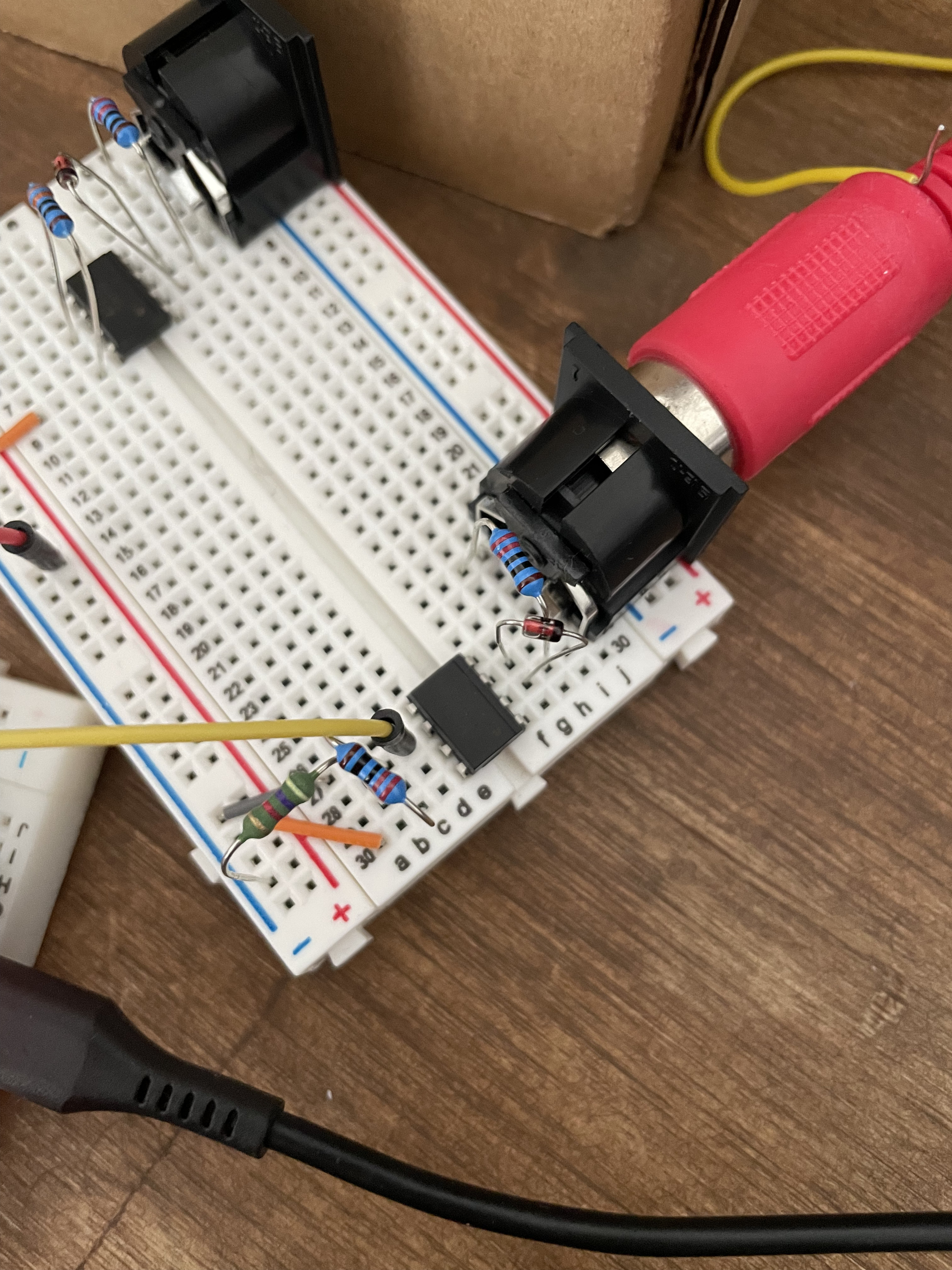

Here you can see my midi-in circuit, connected to the UART4 Rx (Pin 12) of the Daisy. The optocoupler i use is the 6N138 which should be fast enough for midi data (i suppose, as it is recommended in the official Midi documentation).

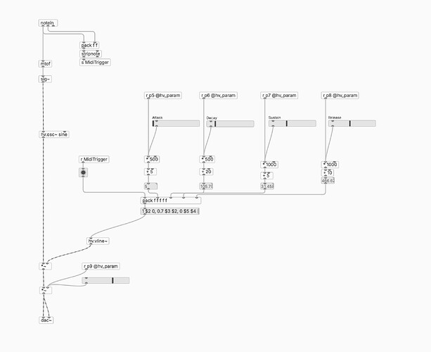

In Pd, i receive the midi note via the notein object and then i process the data further. When i send the midi from ableton directly to plug data i never had any issue like that. Here you can see how i used the midi data to trigger my Amp Envelope.

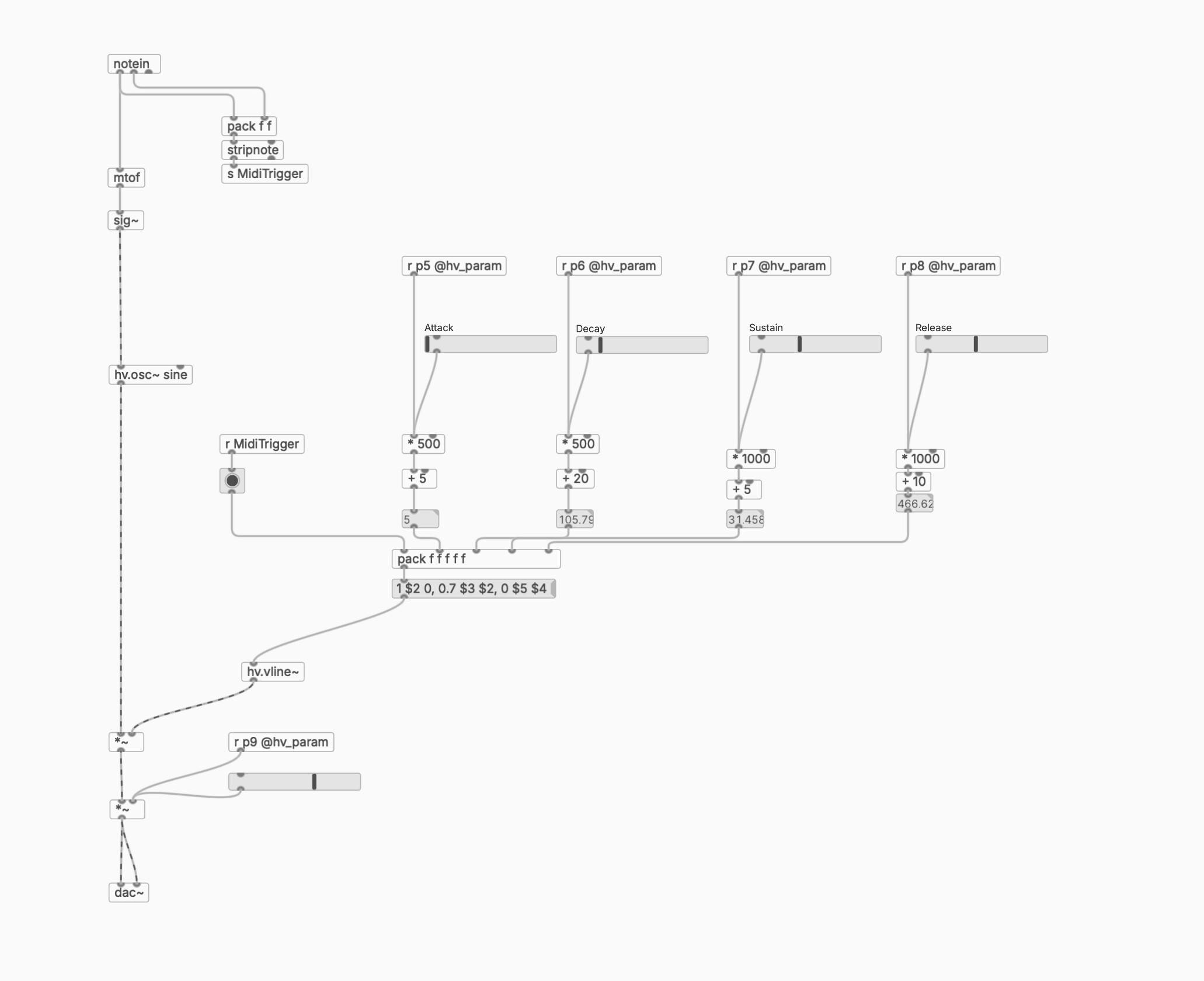

sure! here is a screenshot of the minimized patch as well as the zipped patch. I multiplied the sustain value by 1000 to get values between 0ms and 1second for pluckier or longer notes. When i turn up the analog control to roughly 70% the error occurs. I tried multiplying the sustain value by a smaller number and that solves the problem…

However do note that this is not a “sustain” as you can’t do a sustained enveloped like this (it assumes that you have separate note on and note off events, not a simple trigger event).

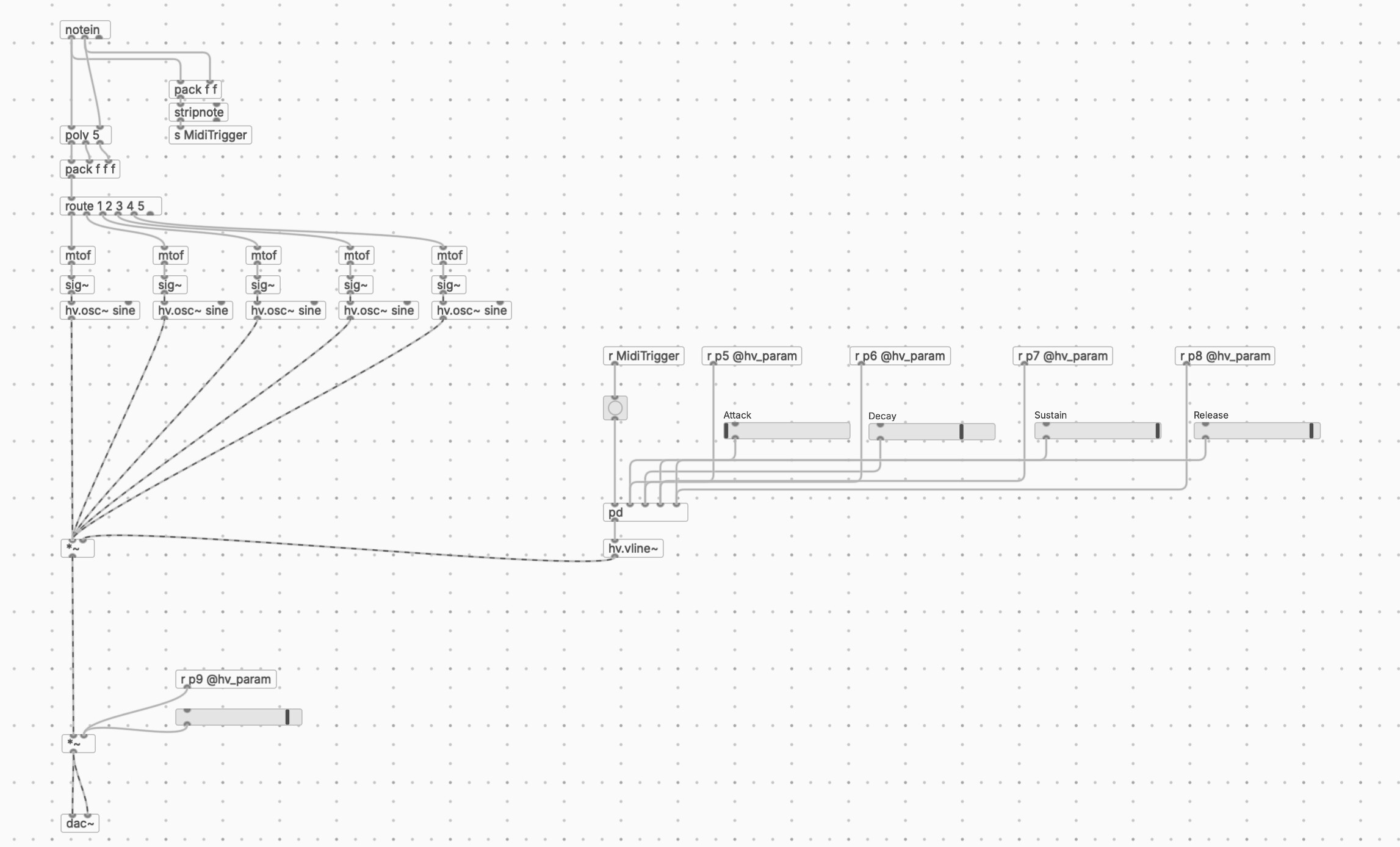

Okay thanks a lot for your support! I will look deeper into envelopes and try out a different way. I just tried adding 5 polyphonic voices to the patch above and that also caused a crash and polyphonic midi was not playable at all so far…
