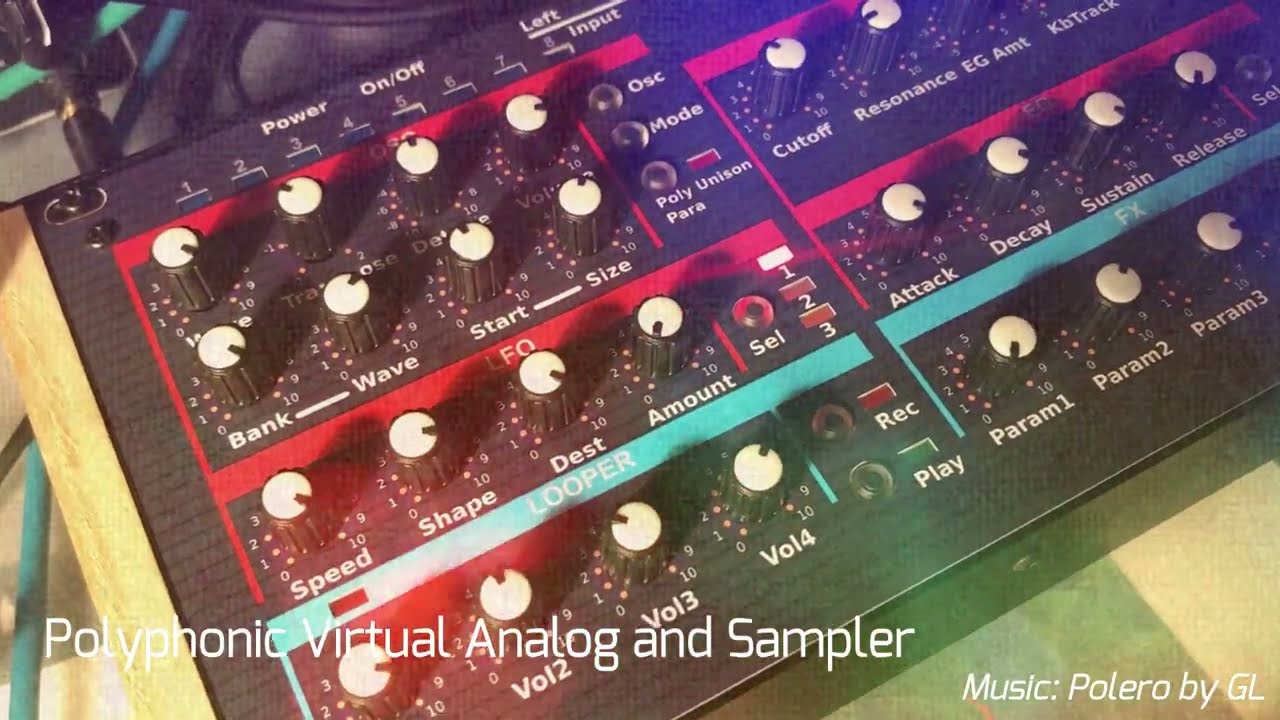

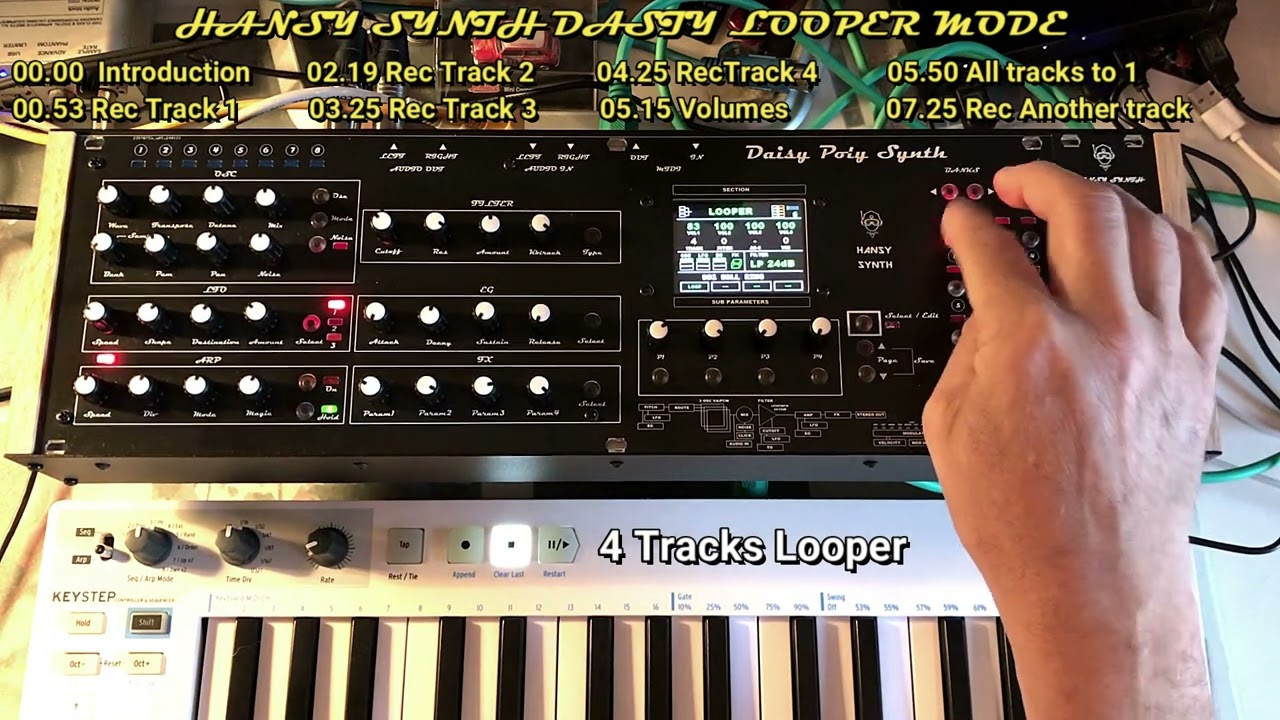

Looper mode for the Hansy Daisy poly synth.
A new front panel for the Daisy Hansy synth
And some new Demo
