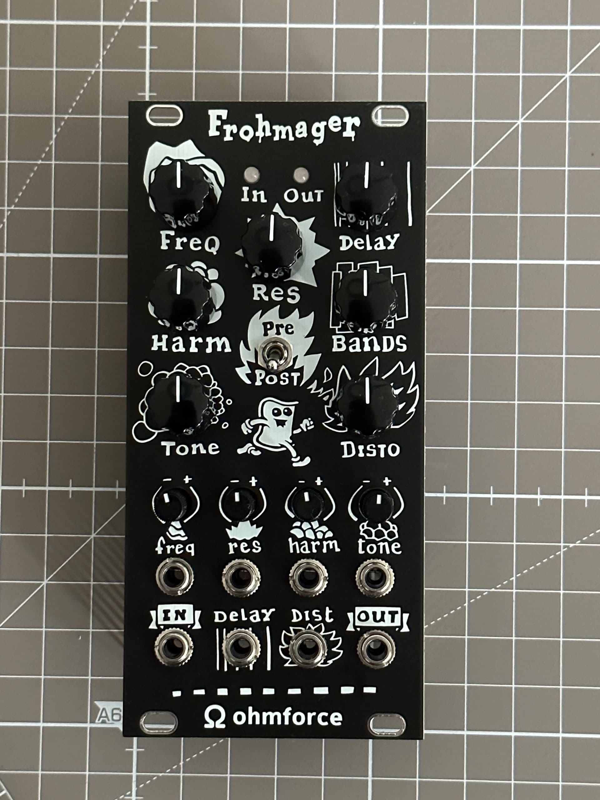

Starter Kit will most likely include 2 front panel modules, the Drop DJ Filter, as well as the Frohmager, the recreation in hardware form factor of the legendary software plug-in from Ohm Force, as shown below.
