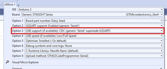

HOWEVER I have found what was blocking the Serial MIDI functionalities. By default, after a fresh install, the option “USB support (if available)” is set to “none”. This must be set to:
CDC (generic 'Serial' supersede U(S)ART)
Apparently this is a global setting that is stored somewhere in the toolchain folders. Probably this was set to the correct value when I started using the Daisy back in 2020, but switching to a new computer this was now set to “none” and I don’t know why. This isn’t saved anywhere in the project, neither using Arduino 2 nor using VisualStudio with vMicro.
The USB setting broke serial MIDI. Nice.
